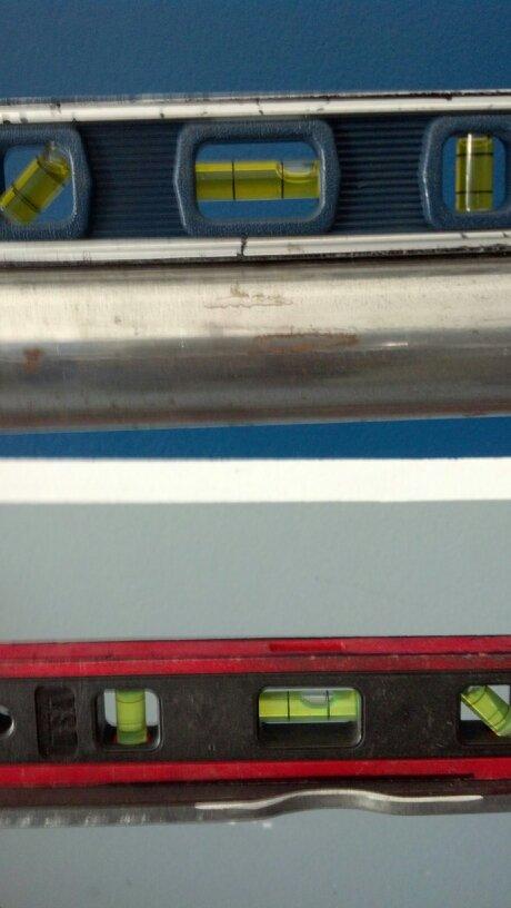

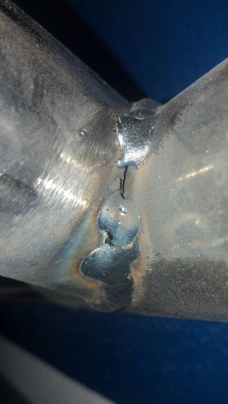

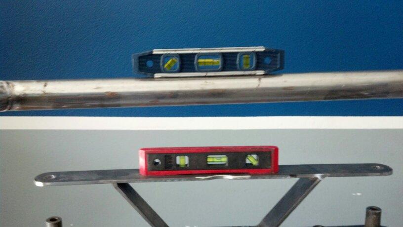

On inspection i found cold/ bad welds, missing upper shock mount "diamond" supports, the cross member only had one mounting location for T56 transmission even tho his new design showed multiple transmission mounting locations,the frame was not Da'd or sanded ready for powder coating as his add stated and the most recent was the sway bar mounting tube not square.
I contact Scott and he refund me $200 for not welding on the "diamond" upper shock support brackets, to grind out his bad welds and re weld myself and to sand the frame myself to get it ready to powder coat. I took the refund because something is better then nothing and he apologized. Recently when I went to install the sway bar it was difficult. I put the frame against the wall and checked for square and measured it and found the sway bar mount was way off.
I again contact Scott and he told me

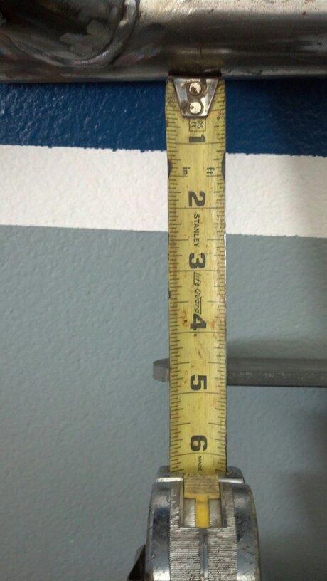

" i already refunded you $200, discounted the frame $500 ( even tho it was a discount for all members), the sway bar mount being off is an easy fix, just cut off one side , square it up and re weld it"
He then went on to tell me I could fix it myself easy or send it back on my dime and he'll fix another of his mistakes.
This was the last draw for me. I told him I'd keep the frame and repair it myself and I'd never do business with him again. I told him he should of done quality work to begin with and not count on the customer to do the repairs. If i didn't know how to weld I'd be paying more then his $200 refund to repair this frame at a shop. After a 3 month wait this frame should of been top notch.
To me customer service is everything and wrongs need to be corrected, no excuses. He did own up to his first mistakes and refunded me $200 but didn't correct the sway bar mistake. It was to many mistakes to begin with. I work graveyard shift and don't have time to return frames on my dime and wait for his mistake to be fixed for the 5th time after I already paid $5400 dollars.
Now I have to, bend and weld on the upper shock "diamond" supports, grind out and re weld bad welds,DA my own frame, cut off the transmission mounts and fabricate and weld on my own and now repair the crooked sway bar mount. All his mistakes.

Below is a few pics of bad welds, crooked say bar mount, etc. Thanks Everyone

Hey Scott, thank you for public admitting your faults. This thread once again was not intended to bash you. But when welds are questionable/structure and my safety and my family, friends are in order now that's important.
I don't build frames or know suspension geometry by any means, but I do mig, tig and arc weld daily. To back grind out most of the bad welds,re weld them,cut off and make new transmission mounting bracket for multiple transmission options, cut off sway bar mount and re weld, bend diamond brackets and re weld, DA sand the entire frame in 3 hours is far from the truth. If you can accomplish this all in 3 hours that's amazing and my hats off to you,but the quality and details don't show in this frame you sent me. But it'll take me 16 hours to do it properly, safely with quality welds etc.
