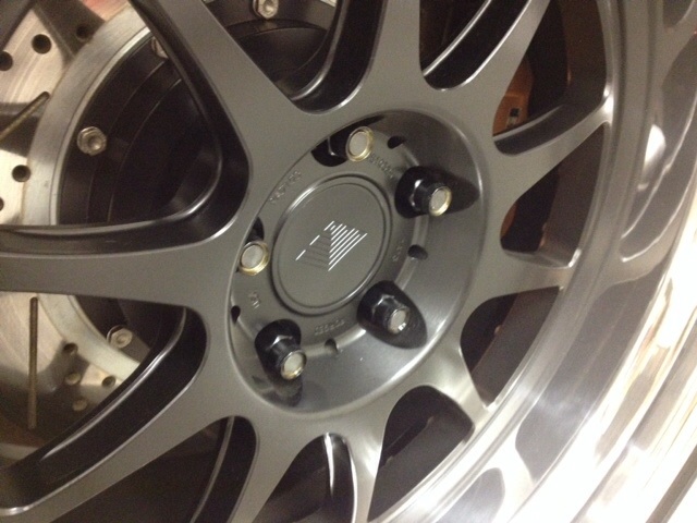

Originally Posted by latoracing View Post
I bought Monster lug nuts for my RAD 14 wheel set up. I am running 3" long wheel studs and needed an open ended nut. They look to be a quality part, and they have a longer body to help get them on and off the studs. A standard open ended nut would be way down inside of the pocket. I haven't mocked my wheels up on the suspension as of yet, but here is an example of what they would look like. I took this when we were checking hub fitment before final finishing.
That is a great looking wheel. You will absolutely love them. Here is a picture of my RAD10s with black monster lugs. I have 3 inch studs as well so I needed the open end lugs. Just curious what everyone else is running.
