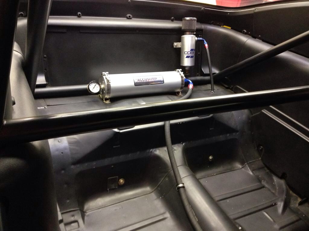

How much of an axle breather is needed? This picture was taken of Greg's Mustang and I don't understand why such a big can....When I played off-road we'd just run the vent high enough to stay out of the water, no can just a filter and check valve, I do realize it was low rpm compared to a track car.
I'm putting together my 9" and would like to understand this a bit better.

I'd vent the pumpkin housing -- vent installed HIGH -- and NOT on the gear side as they'll sling oil at it.
It will also need to be large enough in diameter that it doesn't push oil in the tube and then trying to vent the gas - it pushes the oil up the tube. Had that issue on my '32
A race track doesn't want ANY grease or fluids on the track whatsoever -- so everything MUST be vented to a catch can with some kind of breather/retention... including valve covers etc.

plus catch cans don't come in too many sizes. That ones a universal type.
Back in the old days we use to use clear plastic fuel filters with 3/8" ports. -bout 2" diameter. The oil that gets pushed up goes into the filter then drains back down. The key, you want it to drain back and not fill the can.

Greg is right, you need a large hose. We used the Fram G12 filter's if you wanna go the cheap and easy route. Hook up to the well side not the filter side.
