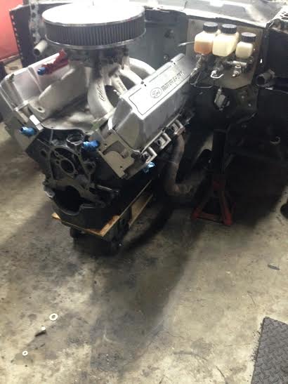

Looking for maybe a little input on front suspension design/geometry... I decided to redo the front suspension on my mustang and this happened:
I have a good plan to tie it all off the the cage, I have subframe connectors I did a long time ago that are stuffed into the frame rails like a foot. So I am basically going to extend that out the front to where I cut, and make a tie in point there...
I'm planning on running stock car products spindles and hubs, Ive got some 6 piston wilwoods that should work. Front steer sweet mfg assist steering rack. SO that is the plan, biggest issue will be wheels. I want to go with a large diameter (18") so I can fit the spindle and balljoints inside the barrel of the wheel. That way I can build the arms and everything wide, but still put a 315 tire up front without crazy amounts of scrub radius....
Bolt pattern on the car will be 5x5 5/8" stud. Id like to get wheels for hopefully 5-600$ a wheel, Ive been quoted like 3500$ for 18's so I was hoping to find a better alternative... We shall see though, id rather not run a 15" , I dont think I could build the suspension with decent geometry and not have my car end up like 6" wider than what I had before..

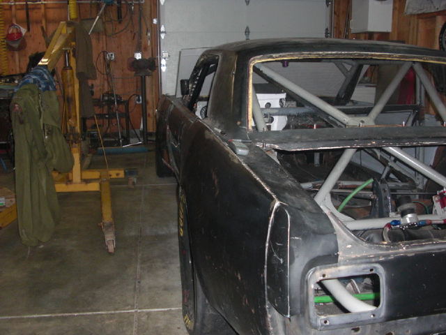

It is a 66. Some of these photos are on various stages of me building it (and progressing skill levels...) You can see the upper link mount in the second pink, I made the upright way too tall, I didnt know where I would want it so I made it plenty adjustable.. I figure this time around I may build a chromoly housing to drop some weight and make it nicer but we will see.

Very cool, looks like fun to me! Nice to see a coupe and a wide body at that, are the panels pulled out or fiberglass?
Dan
Old 08-13-2014, 04:48 AM
358Mustang 358Mustang is offline
Join Date: Aug 2014
Location: Campbell, CA
Posts: 73
Thanked 3 Times in 2 Posts
I basically used two fenders per fender, and two quarter panel skins, per side and I cut the original one, then put the overlay skin on, and "pinched" it in the middle and pushed it out that way, then just welded it together
