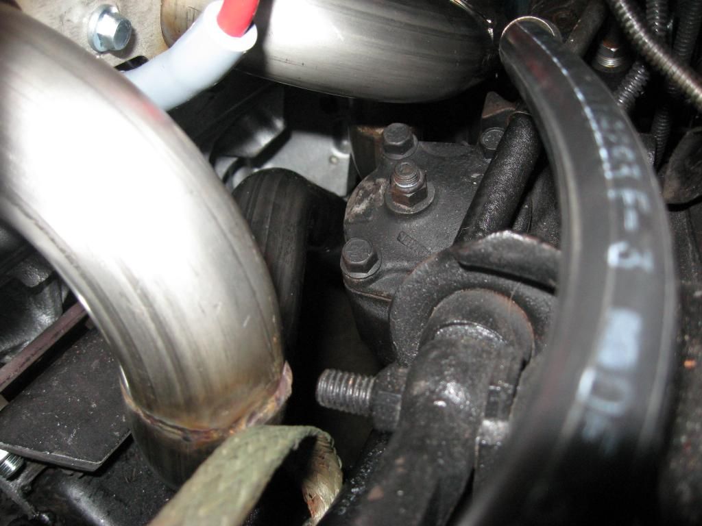

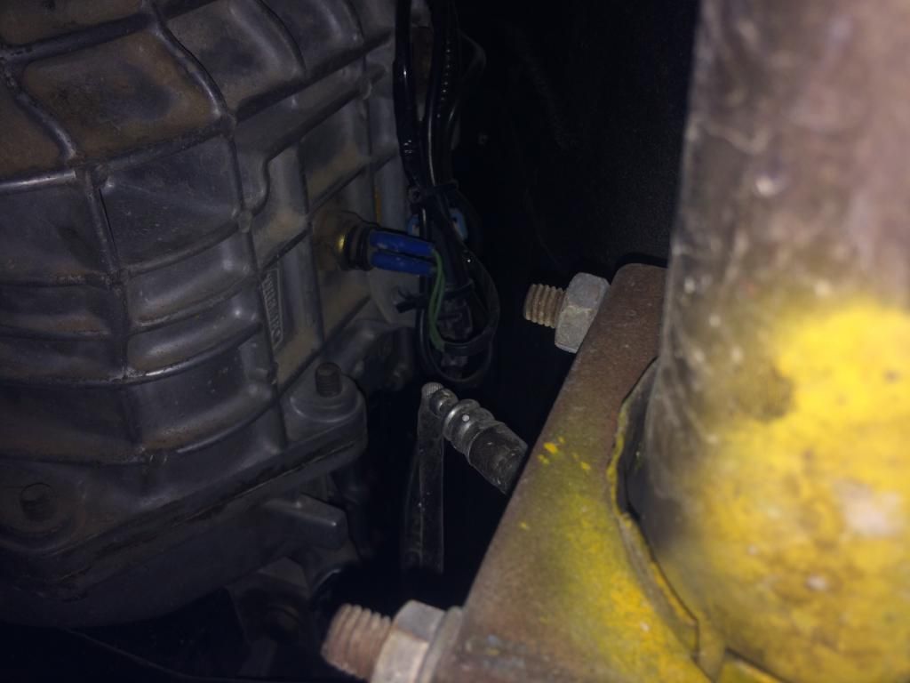

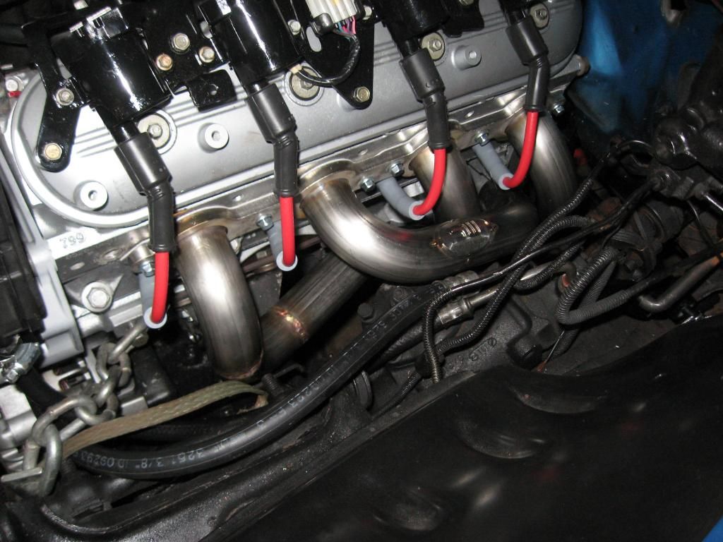

After battling an unsuccessful set of ls swap headers for 1st gen camaro I went to Henson Supercars and they set me up with a set of stainlessworks headers. These headers are the way to go! I made my own engine/trans mounts to get the engine as low and far back as possible without cutting up the firewall and they still cleared my control arms and steering box perfect! Only problem is the tip of the z-bar of the clutch fork side is rubbing one of the tubes, I might just switch to hydraulic so its not a big deal.
Here is a picture of my first set of "direct fit" swap headers, they hit the steering box bad and the passenger upper control arm
And the stainless works
Night and day difference in the clearance (and price) but I think they are well worth it! Hope this helps out someone else before they get cheap "swap" headers like I did.

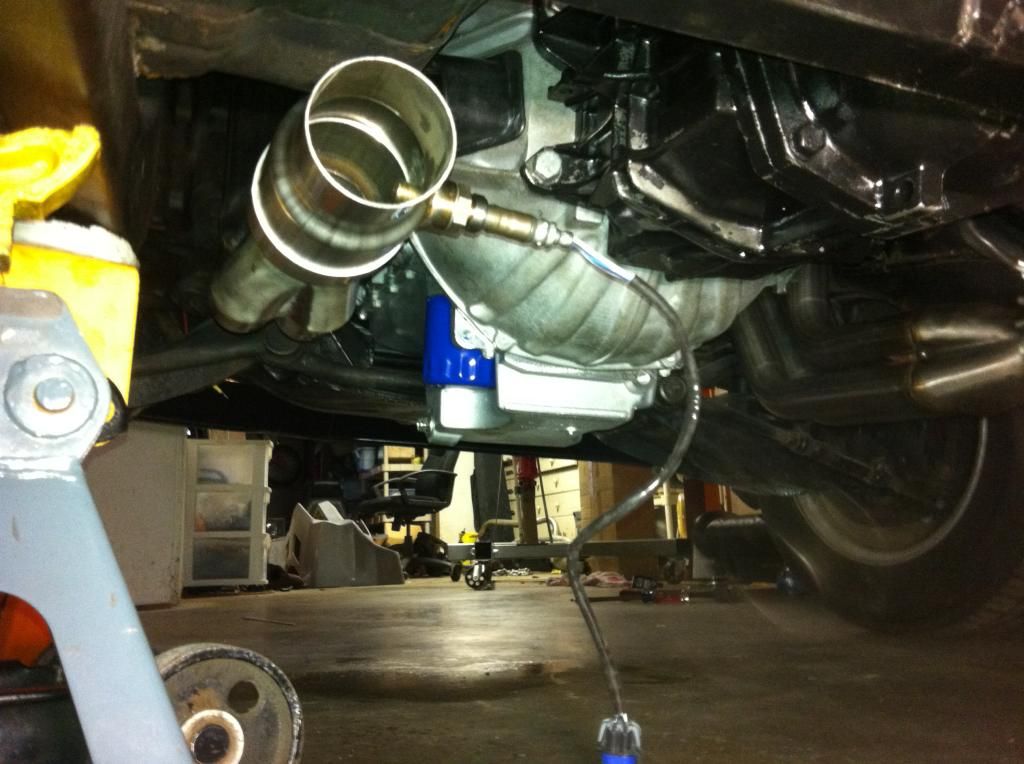

Just wondering if you have a photo illustrating the slip fit connectors with the clamps. Mine is leaking from the connectors because they have removed several times and joints became enlarged a bit

Originally Posted by 72Z/28 View Post
I have the same headers as well through Speedtech along with their front clip and rear suspension.
I'll take a pic for you today. They look like the same slipfit used on the 5th gen. I think I have a spare set from my headers I didn't use, I'll check.

Old 09-06-2014, 09:20 PM
CamaroMike's Avatar
CamaroMike CamaroMike is offline
Join Date: Dec 2013
Posts: 209
Sorry for the quality, took them with my ifail

Old 09-07-2014, 01:54 AM
72Z/28's Avatar
72Z/28 72Z/28 is offline
Join Date: Dec 2009
Posts: 375
Thanks: 4
Thanked 13 Times in 11 Posts
Thanks alot for the photos. I noticed that the O2 sensors are welded to the stepped connectors(assuming these are the connectors not a portion of the cat back that is going to be welded to the stepped portions)

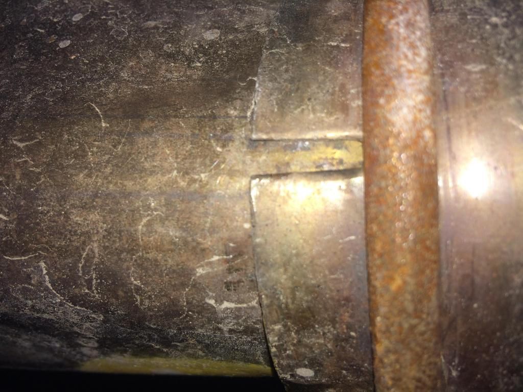

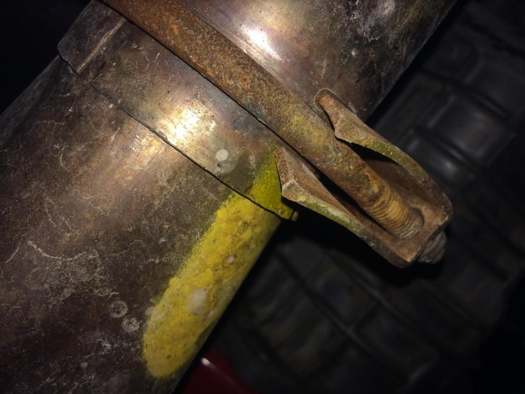

The clamps you have are different than mine. I will try to take some photos and send them to you for comparison purposes.

Old 09-07-2014, 01:01 PM
72Z/28's Avatar
Join Date: Dec 2009
Posts: 375
Thanks: 4
Sorry for the crapy photos. The above photos show the type of the clamps I have, and the last photo illustrates the carbon deposition at the area where the leak is.
I am wondering if I get a wider clamp to press the little openings from which the exhaust leaks.

Old 09-07-2014, 06:25 PM
CamaroMike's Avatar
Join Date: Dec 2013
Posts: 209
Ditch those clamps, the chevy dealer should have some like mine. I put some headers and magna flow exhaust on a 5th gen camaro and if I remember correctly it reuses the factory clamps that look just like the one I got from stainless works. I know SW changed their design so they probably don't even sell the older style horseshoe clamps. Maybe they will send you some new clamps but that should fix that leak, hope this helps.
