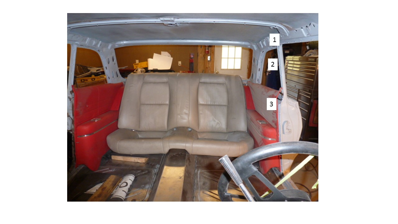

I need some ideas on where to mount the upper portion for my three point seat belts. I am thinking along the B pillar (#2 in picture) but, it isn't as well reinforced as newer cars the same issue goes for #1; it's not reinforced very well. I could put it on the lower point (#3) and it would be much easier to reinforce but, I'm a little concerned that it would be too low. I'm open for suggestions.

Is this for daily use or track use?
By the position of the number I assume it's for the front seat. Do you have a design in mind?

You might also go to the Schroth website and check their technical page on mounting. It may give you some ideas.

Mostly daily use with some track time. I have some ideas for building the reinforcement plate, just need to pin down the location for it.
I have thought about putting a harness bar in it and running Corbeau retractable harness belts.
