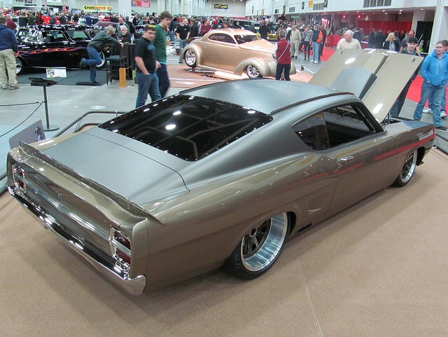

I did a quick search over on one of the landracing sites and didn't see anything specific. Radrides Torino and Barracuda are good examples of roof rails done well. I'd imagine at the speeds you'll be seeing, Velcro or double back tape isn't going to cut it! Love the camaro, I'll keep looking.
