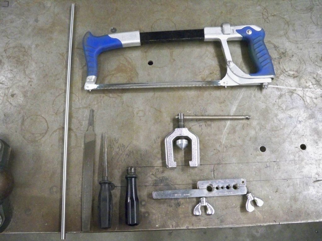

i want to do some stainless lines and would like some info on tubing type,best suppliers,bending tools and flaring tools that members are using.i know its probably been discussed many times but cannot find all the info i need. thank you

Pure choice motorsports is where I order my stainless line from. Very knowledgable guys. I also ordered a hydraulic flaring tool. It is the only way to go. Go to harbor freight and buy the little blue tubing bender. It's the best cheap tool ever.

If you're a rookie (like me), you should consider doing everything in with carbon steel tubing first for practice. You can get CS tubing very cheap at your local auto parts store.
You don't need a hydraulic flaring tool. Just get the Eastwood one from Amazon - you have to put some extra elbow grease on SS flares (make sure you double flare everything!) versus carbon steel since the material is a lot less malleable. They have videos for this tool online.
http://www.amazon.com/Eastwood-Doubl...e+flaring+tool
I ran all the brake lines for my 69 firebird (you can see some photos in my build thread) and it worked out great. I can't stress enough to form everything in CS first. Also, on the bender - just get a cheap-medium priced one from amazon or your local parts store - try to learn what the marks on the side of the bender mean. Use the throwaway CS to experiment. This will save you time in the long run.

It's been working for me for over 20 years. I do have a industrial style flare machine. But every once in a while I revert to a hand held flare tool. I use a imperial flare tool. It will allow the home builder the tightest 90 possible at the end of a tube. The picture below is everything a do-it-yourselfer needs to single or double flare tubing.

Good examples Modern Museum! I tell people to practice all the time with the bundy tube first. Then duplicate your patterns into the stainless. Make sure the bender you use is designated to the tube size your bending.
Not true about double flaring everything.... Usally the S.S. in the aftermarket that comes in the spools is either a thinner wall tube or lower quality material and extra soft. Which is probably why you can double flare it ? I personally WILL NOT SACRIFICE A LIFE FOR A CHEAPER PEACE OF BRAKE LINE TUBING.
Good quality tubing you will only need to single flare. Just like it's always stated in ALL of these topics on flaring. "You need to crank hard to flare S.S. tube (not true)" Well if that's the case why double flare it ?
Yes the pricing isn't cheap for the good stuff, but what isn't ... And what's this all worth in the long hall in a car you just put your blood, sweat, tears, and MONEY into ? I think it adds an extra sense of security, resale sell value, and knowing it's your BRAKE SYSTEM and not an overflow tube.
Modern Museum I want to make sure that I'm not coming down on you in any way. Just trying to give some light on my experences over the last 20 + years of doing this stuff... You bring up a lot of valid points that are always the topic of plumbing.
