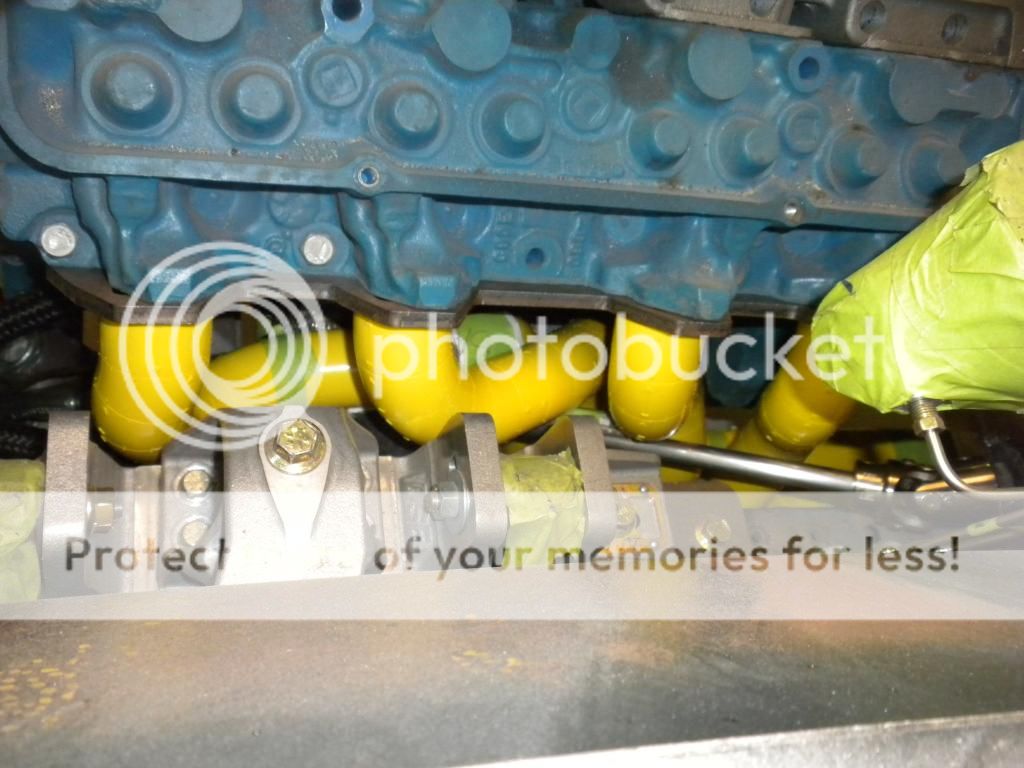

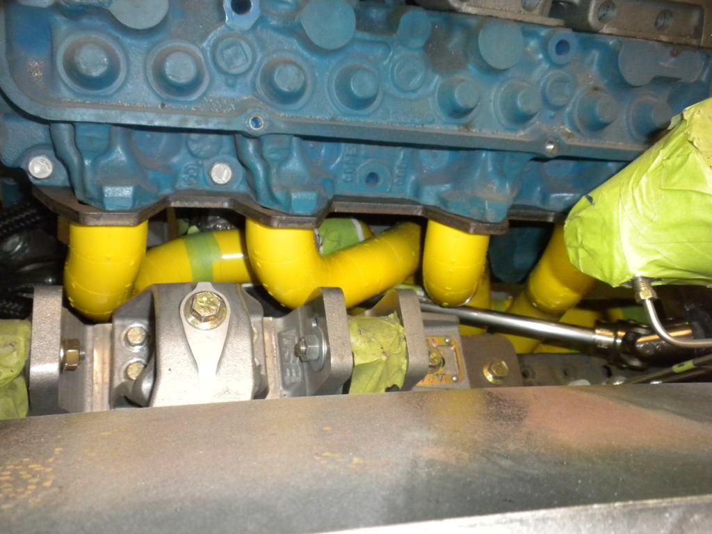

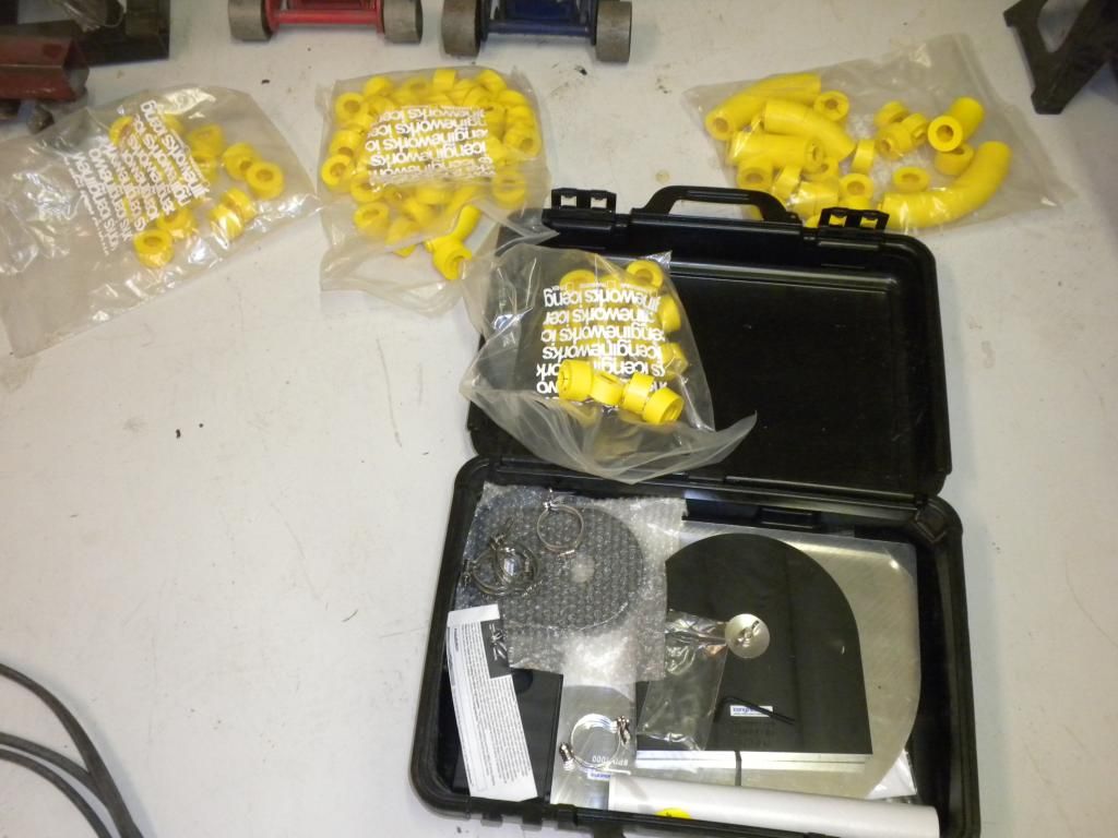

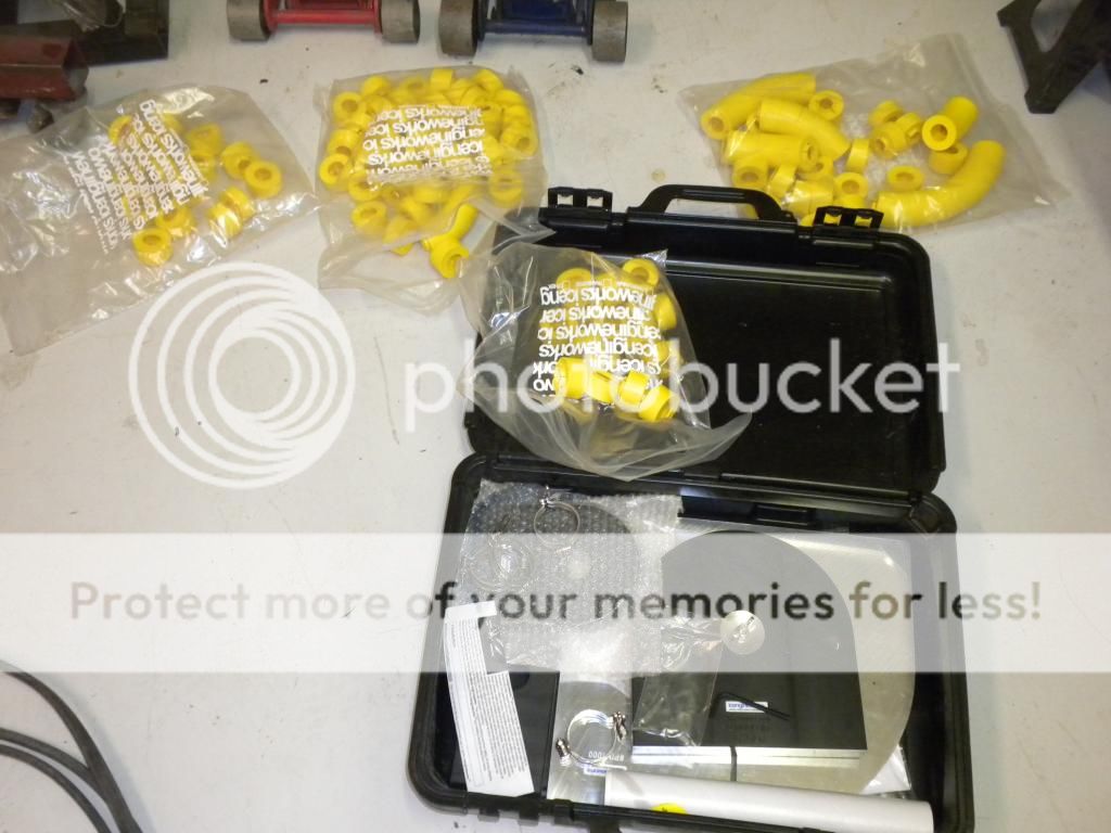

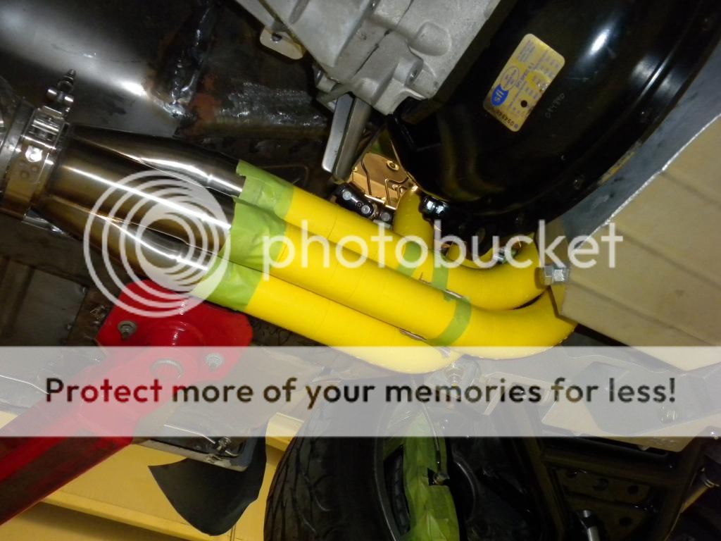

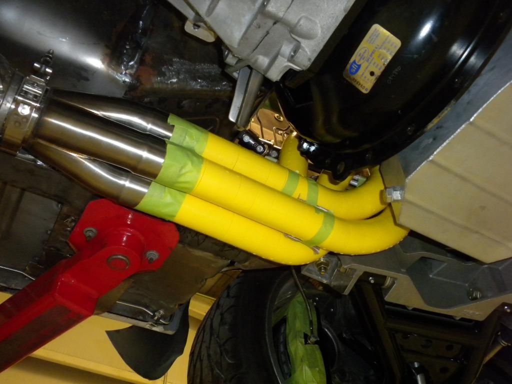

What is the best source for buying stainless steel tubing for building headers that sells different radius bends?
I'm starting into this Ice Engine Works header modeling kit and will need tubing soon. I'll post up pics when it looks like more than a pile of Legos

I use Vibrant tubing primarily for most of my fabrication projects but they don't offer their tubing in different radii. I'm building a set of headers using an Ice Engine Works kit and the blocks are made to match 3",4",6" radius tubing so I need to find a source that sells all.
Very cool stuff if you need to build custom headers and don't mind a little TIG work!
