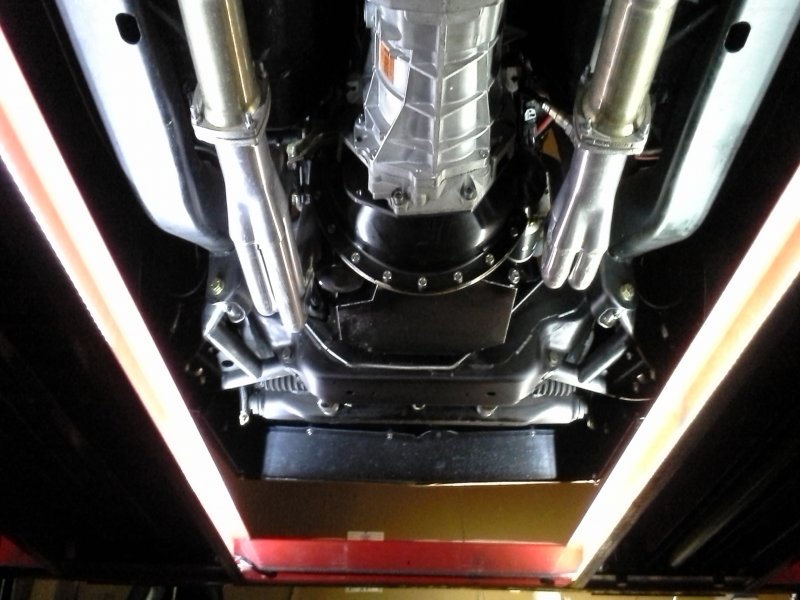

I installed a couple of LED light strips on my four post lift to illuminate the underside of the car and it turned out so well I thought I would share the project because I know some of you have lifts and might be interested. I have seen complete lift lighting kits for sale for around $400 but I purchased the component parts on Amazon and I have around $90 in the lighting project.
Here are the LED strips I used, you need two strips.
http://www.amazon.com/gp/product/B00MPDA8WK/ref=oh_aui_detailpage_o07_s01?ie=UTF8&psc=1
Here is the power supply I used.
http://www.amazon.com/gp/product/B00...?ie=UTF8&psc=1

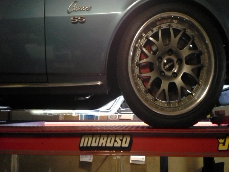

I attached the LED strips to the lift with 3/4" 3M attachment tape. Here are some pictures of the lift lights so you can get an idea of the lighting effect.

How are they about shining in your eyes? I desperately need better lights for under my car when it's on my two post lift, but I've been hesitant to put any on my lift arms or columns because I was afraid of them blinding me at times as well.

I have not noticed the lights blinding me as I work but what I have noticed is that light is more evenly spread with no shadows. You could buy a single strip and cut it in half for a 2 post lift. All these strips come in 16.4ft lengths.
