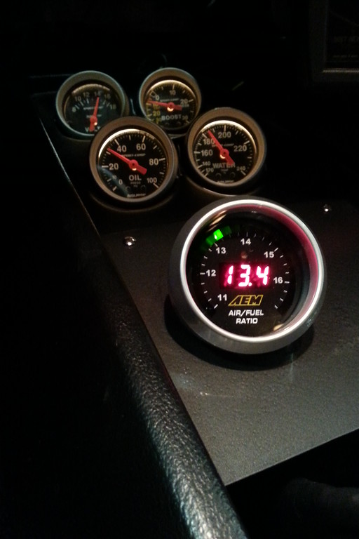

I recently installed the AEM unit and have zero complaints.

Dang, okay... AEM it is then. Thanks everyone.
Now I just have to find a place to put the gauge. I hate that part, I'm not one to cut up my factory dash.
