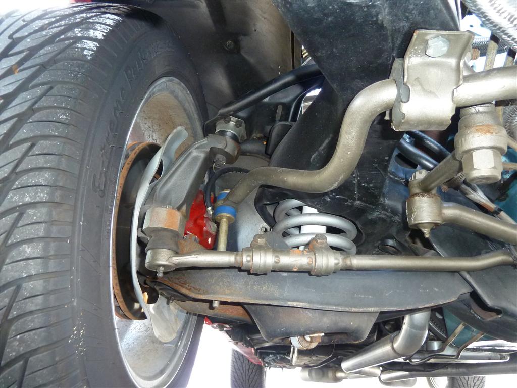

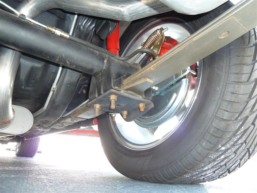

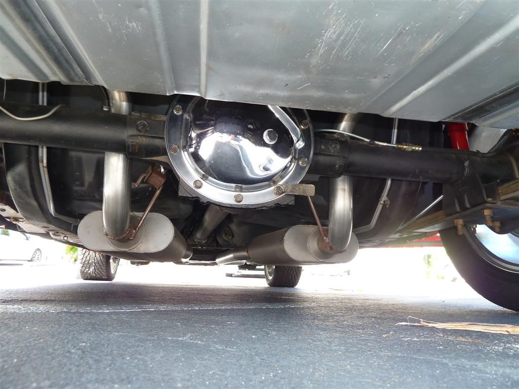

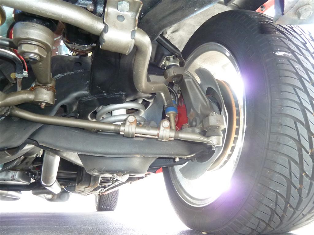

I will try to attach some pictures (not sure how it works...) of the underbody so that you can figure out how the car is right now.

I vote for the basics since its just a road car.
Hotchkis leafs and coil springs to drop you 2" from current
Hotchkis front hollow sway bar 1 1/8"
Hotchkis Subframe connectors
Hotchkis subframe down bars
Koni classic shock OR Ride tech HQ shocks
Quick ratio steering box, Delphi 600
275mm tires on new 18" x 9" wheels with the correct backspace.
