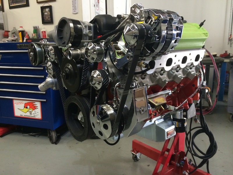

I just put an Autokraft on my LS3/525 crate motor to work with my Speedtech sub frame.
Perfect and great ground clearance.
