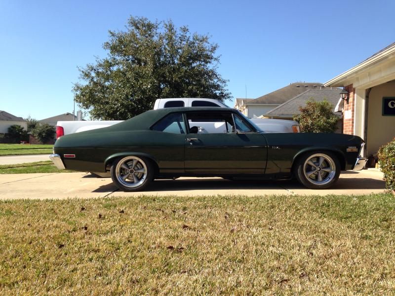

Having some ride height issues with a set of Detroit Speed 3" drop leafs I recently installed on my 71' Nova project. I am running there speed kit 1 front and rear which basically consists of the their upper/lower control arms, 2" drop springs up front, and 3" drop leafs in the rear with the red DSE koni shocks all the way around.
Currently the car is sitting 2" lower than the front, on the passenger side rear & 1-1/8" lower on the driver side rear. Front is dead nuts level from side to side at 23 5/8".
Measurements at each corner are:
Driver Front: 23 5/8"
Pass Front: 23 5/8"
Driver Rear: 22 1/2"
Pass Rear: 21 5/8"
I have spoken to DSE about the issue and they can't peg the source of the problem and have offered no real solution. This car is a very clean 2 owner, low mileage car that has never been wrecked, raced, abused, etc and has all original sheet metal so I find it hard to believe it is the car.... All suspension was tightened after weight was on the car, and the car has enough miles on it now where settling shouldn't be a factor anymore. With any additional weight added to the trunk or rear seat passengers will make this problem even worse.
DSE claims that this combination of parts should sit level, but in this application it clearly does not... These issues have me contemplating a rear leaf spring swap and possibly a shock upgrade? Looking at the Hotchkis 3" drop leafs and their fox shocks all the way around as a possible alternative? and or ridetech smooth body Q series shocks...
I'm hoping someone else has ran into a similar issue or has a better combination of parts I can swap to? Due to time and money constraints a 4 link or torque arm swap just isn't in the cards at this point in time.
Any help and all suggestions are appreciated!

What are the measurements at the rockers (front/back).
It seems to me that the rear wheel openings on Novas are a little flat at the top, whereas the fronts are more rounded, making it looks like the rear is lower than the front.
Maybe it's optical illusion, but your car actual looks like it sits higher on the rear, based on the ground clearance

I agree with the previous post that your car is not lower in the rear, it only looks that way because of the difference in the arch of the front and rear wheel well openings.
I doubt there is anything wrong with the DSE stuff and I doubt that swapping them out for different leafs/shocks will change anything. Obviously you need to be measuring with the car on a level surface, not so obvious is how uneven level looking concrete can be. If you haven't done so already, move the car around and measure, I'll be it changes some. If you can't get happy with it you could experiment with a little shimming. You may not be able to get it perfect but should be able to get close.

The stance looks pretty good to me and slightly higher in the rear. Though without pictures on a level surface it's hard to be certain.
How many miles have you driven on the set up?
Use a digital or bubble level on your rocker to determine front to back level. Check with a full and empty tank to know the difference. Maybe use the rear lip of your trunk lib to determine left to right level?
Do you know that your rear wheel opening arches are exactly even? You could pull the rear wheels and run a string line down the rocker extended into the wheelwell and check the arches.
Are your leaf bushings and shackles lubed and evenly torqued?
Did you compare the spring arches before installation?

yep, look at the body line and not the wheel openings.

Sorry missed that. There are alot of variables with these old cars. Body sheet metal off abit or a slight difference in frame rails.
We had a similar deal with a 69 Camaro and Hotchkis leafs. Even switched sides and it still existed.

I don't think you have a suspension component issue. Here's why...
If your car, or any vehicle is low, or high at a given corner, the opposite corner of the vehicle will be the opposite in height. For example, if the RIGHT rear of my Chevelle is low an inch compared to the left rear, then my LEFT front will be somewhat higher than my right front. Corner weights work the same way also.
Vince hit the nail on the head. These cars have a variance. It could be that your cars sheet metal has been replaced, and whoever did it didn't keep the car square during that process. I'm guessing, of course. You might have a pristine car that's never had any sheet metal work, rare, but maybe.
Another thing I'd look at if I were you, are the front springs. If they are not seated, or indexed properly, it will throw the rear end heights off, and it would be way more exaggerated at the rear, due to the Novas design of a short front overhang, and a long rear overhang.
Just some thoughts...
