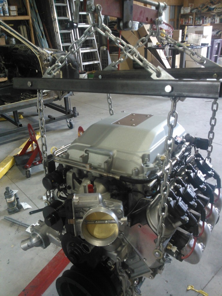

I only do an engine every year or so. I cobbled this one up based on a pic I saw somewhere, maybe on this forum.
Don
