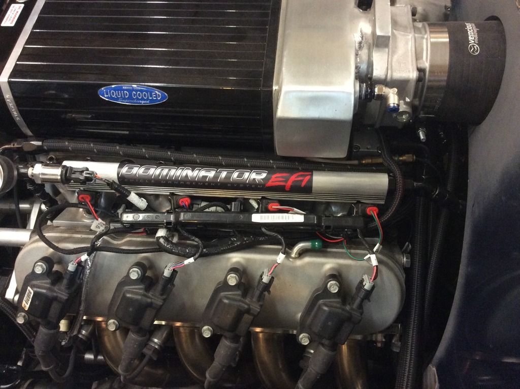

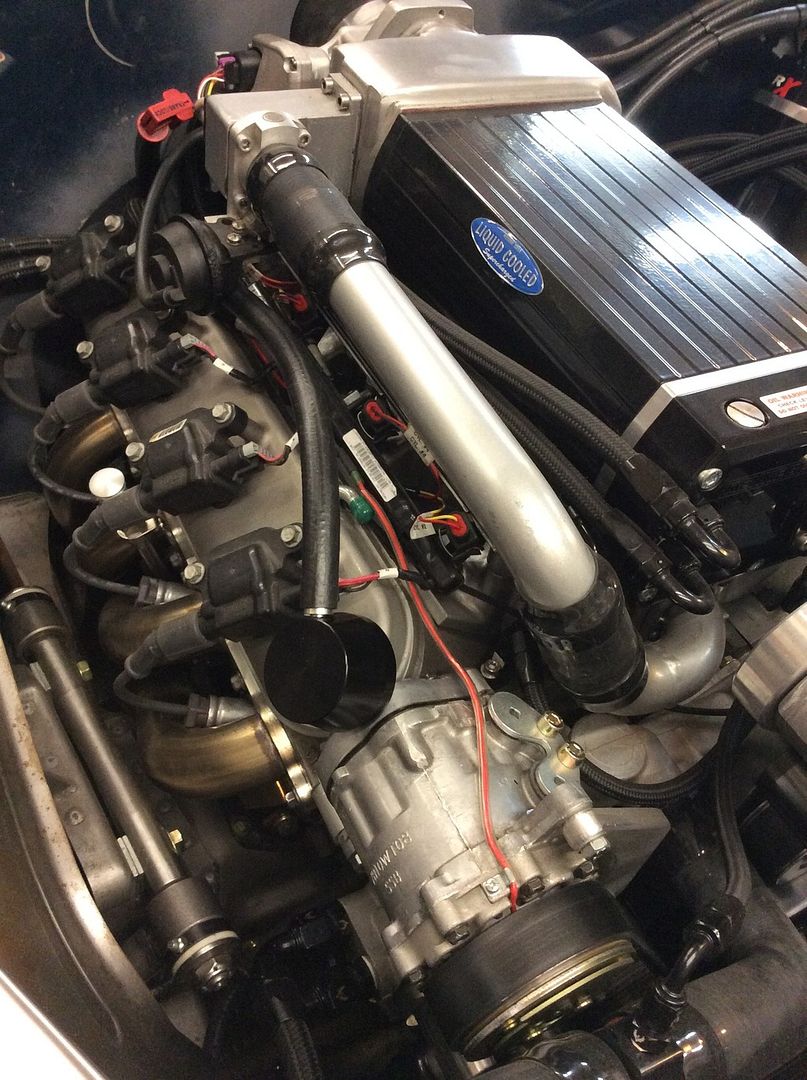

i need to run a PCV on my ls2 but am having a problem figuring out how to go about it.
In the picture below it shows a port on the drivers side vale cover( green cap on it) and also a vacuum port on the back of the blower intake.
Also on the second picture I have another port on the rear of the supercharger intake and a plugged fitting on passenger side valve cover.
What are people using and how do I run the PCV system?
Let me know if further info is required thanks- Tim

The problem I have is that there is no fitting before the throttlebody ...just the two in the intake.
Tim
