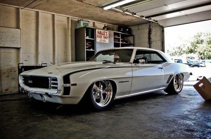

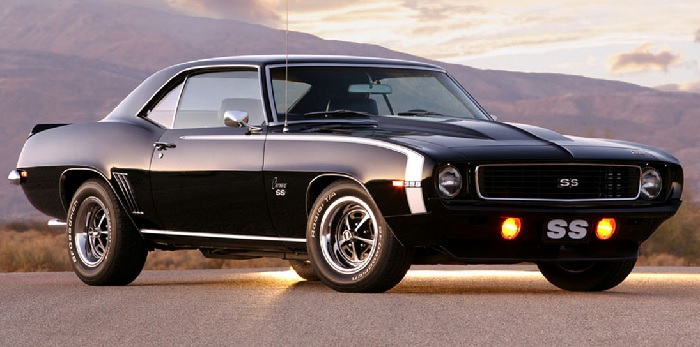

Depends on the look you are going for.
Fatt tuck look or oh yeah, its a 69 Camaro look.
I tell you that I hear way more "Damn, I should have mini tubbed it" than "damn, I should have not mini tubbed it".
