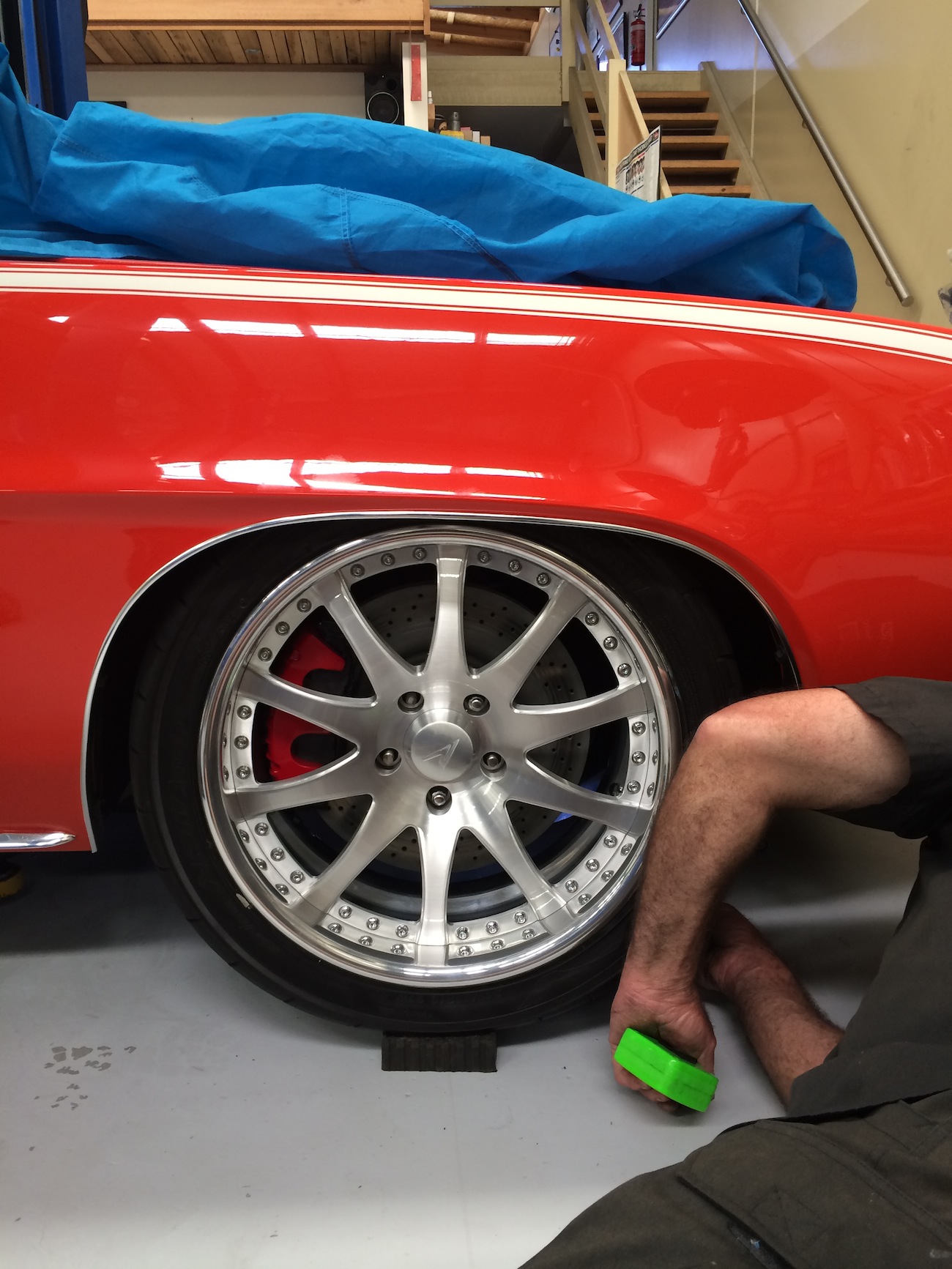

We have just installed Ridetech Tru Turn on a friend's 69 Camaro here in Australia. We installed a Speedtech steering box at same time.
This car is 100% street driver and he is really pleased with how car now drives. But it is just sitting too low for regular use. Car runs a BBC with 4L80e.
The initial install was with 1" lowering Global West springs, which was way low, with the built in drop of the Ridetech spindle
Name:  No spacer.JPG
Then added a 3/4" spacer
Still a little too low, would like to raise it another 1/2".
Can anyone recommend a stock height spring to suit BBC with uprated spring rates?
thanks Roger

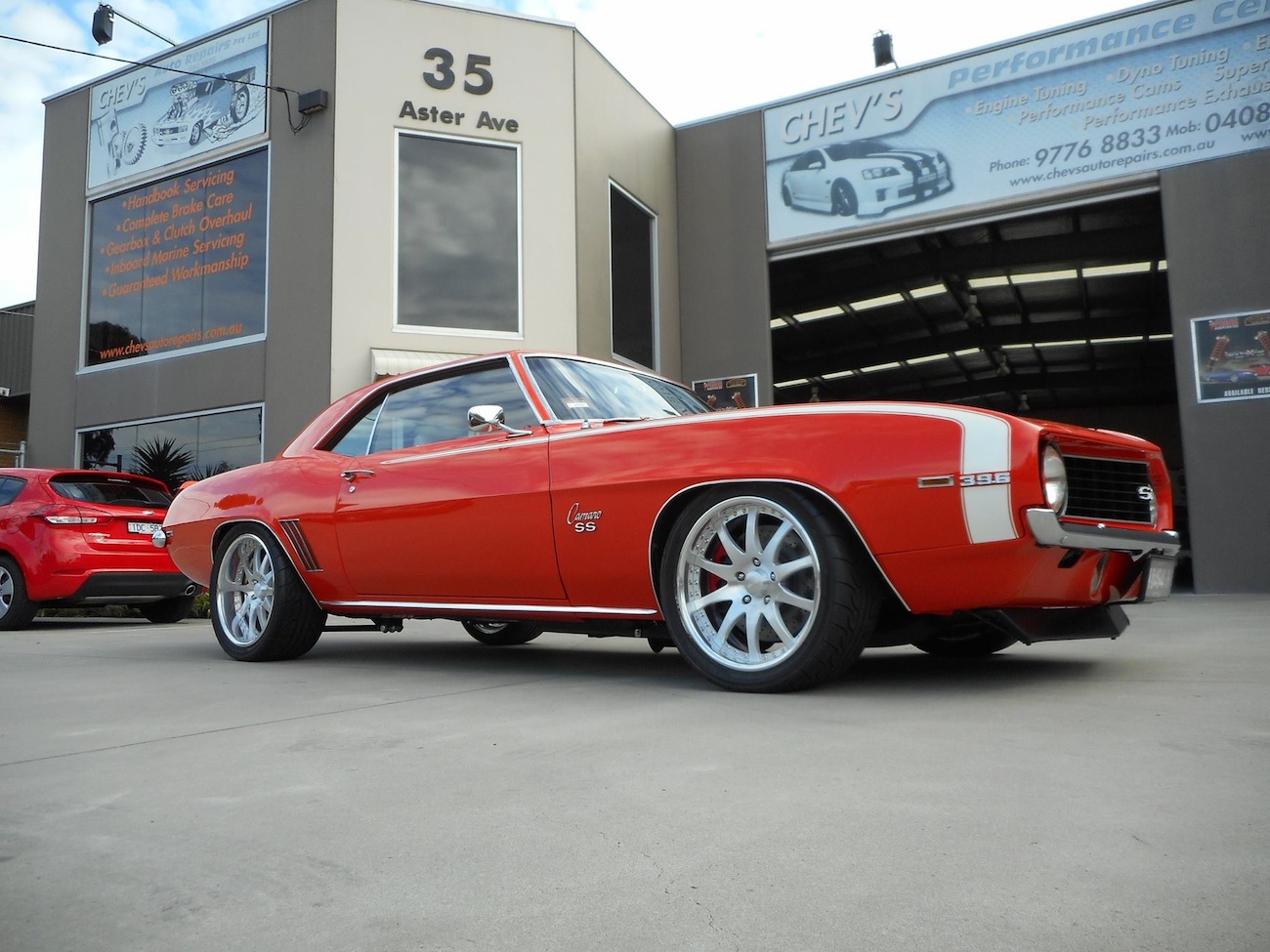

I'm no help at all here, but I think the car looks great! The sidewall ratio to fender lip looks about perfect to me. But I can tell you with certainty that the Hotchkis 2" drop spring is WAY too low with the Truturn!

Josh, running stock control arms. The plan for this car was to improve street manners.
The Tru Turn has certainly done that. Just need to sort out ride height.
We have purchased a set of Moog 6041 springs here locally, should have on Monday and hope to install Tuesday.

Thanks Jimmy, yes it certainly is a looker.
Unfortunately at current ride height he cannot get it in his garage
Roger
