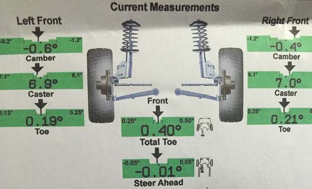

I finally had the time to take the car in to get aligned and here are the results:
Please let me know if there are any figures I need to be concerned about.
Overall, the car handles great and tracks well.

I'd bring up and even out the Camber to -.8 If your tires are hitting your fenderwells you can back down the caster. Otherwise it looks good.
wheel centered and car tracks straight?

Vince,
Steering wheel is perfectly centered and it tracks very well. Thanks for the input on the camber.
I need to check to see if I'm rubbing on the fenderwells but haven't had any obvious signs.
