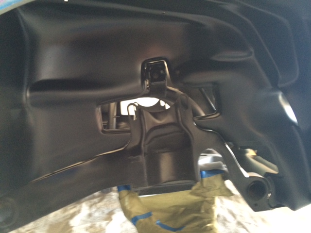

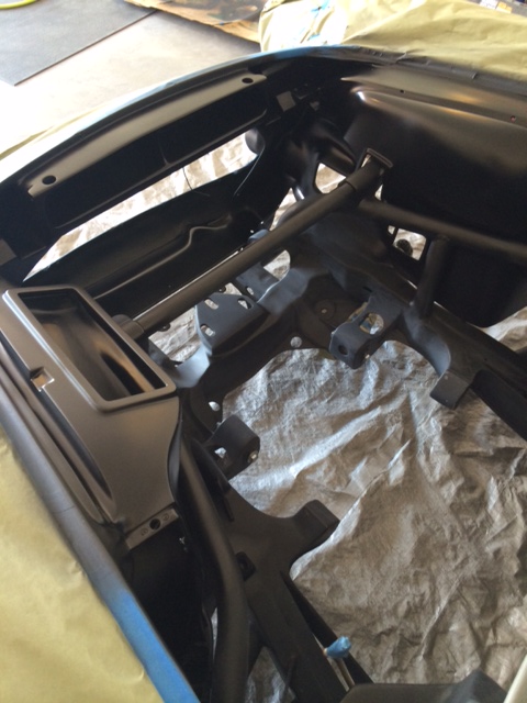

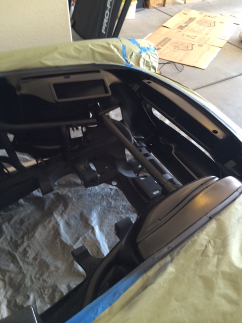

It has been a while since I posted, but major changes take time. I re-did the front suspension to be high travel/low roll, all pick-up points adjustable on slugs, zero scrub, longer control arms, with 335 front tires. It was difficult to get the room to turn the big tires 30 degrees with the suspension compressed 4+ inches, but nothing a chain saw couldn't fix. Thanks Ron. Here are a couple of pictures of the front inner wheel tubs that I just finished up. They will give you an idea of the extent of the modifications. Now maybe the rest of this thing will progress a little faster.
Pappy
