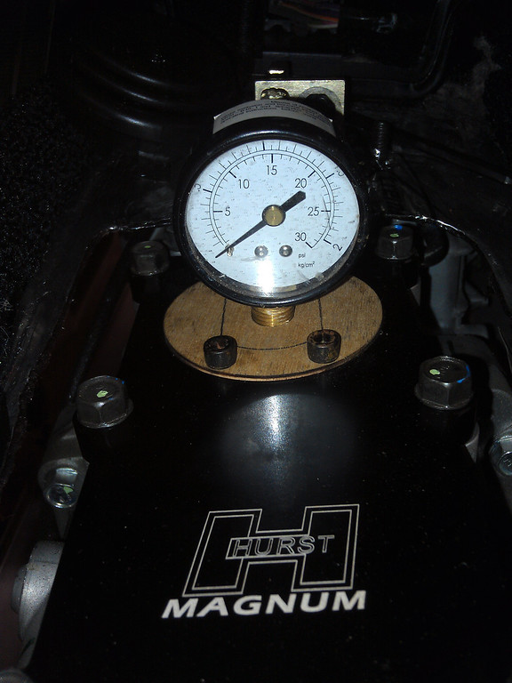

Regarding leaking - Make sure the factory vent is functioning properly. If not the trans can create excessive internal pressure that will push fluid past the seals.
I quick fabbed this to check the venting.
