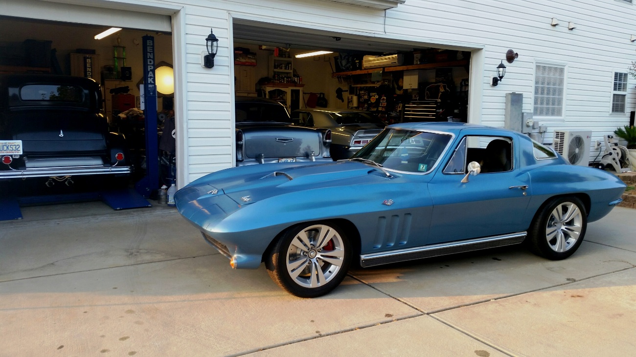

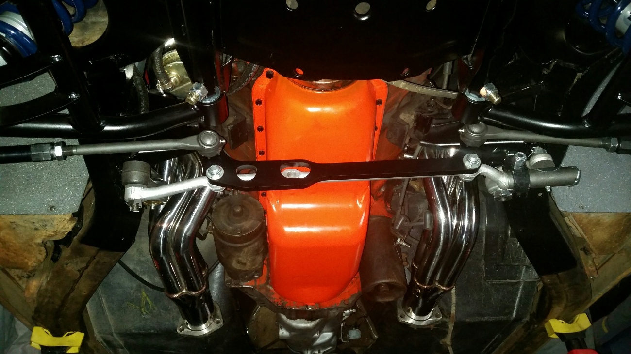

Just retired and had always wanted a Corvette C-2 coupe to build. I was successful in finding a 66 coupe (15 miles from my house) that had been out of service since 1982. It was complete except for front bumpers. It was a matching number's 327 CI/300HP/4 Speed car which I really didn't want because my goal was to convert this 49 year car to modern susp/engine/trans/etc (got lot's of grief from the Corvette restorers group on this plan!). Someone had added a 67 Stinger hood to the coupe and aluminum Corvette Valve covers which were the only non-stock items on car. I purchased this car in mid March of this year and after a couple of weeks of cleaning years of dust/rodent nests, etc. I was successful in getting the original engine running . The engine had 90K miles and after driving awhile and checking the compression it needed a rebuild.

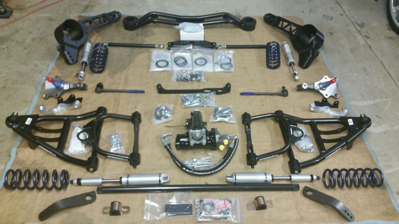

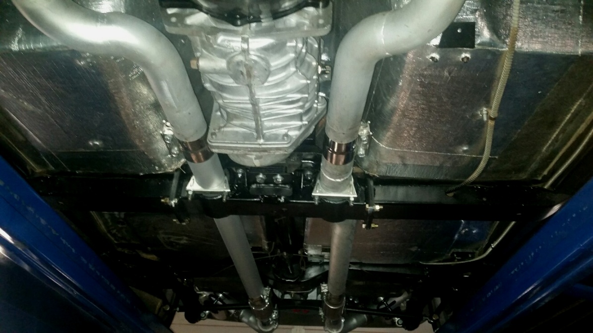

Fast forward to today.......I installed a complete "Ridetech" stage one front/rear susp system with coil over shocks, sway bar, Borgeson quick ratio p/s, late model Corvette Z06 brakes, 17" rims, C6 leather sests and various other upgrades. I also installed a 383 storker motor with 400HP/420 lbs torque and just recently added a Tremec TKO 600 5 sp overdrive trans. My plan is to drive it awhile and sort out things and probably have body/work paint next year. I kinda like the great Patina the car currently has but will eventually have the car painted. I've started working on the interior where I added upgrades like 2008 C6 leather seats, modern 3-point seat belts, Ididit tilt, and completely covered interior with Dynomat. It's been a fun ride so far and look forward to putting some miles on this classic Corvette with modern susp/drivetrain/ etc.! Here's a few of the project pictures:

Cool! I like the contrast of the new parts with the patina of the car itself. But the starter and oil filter have got to go! ; )

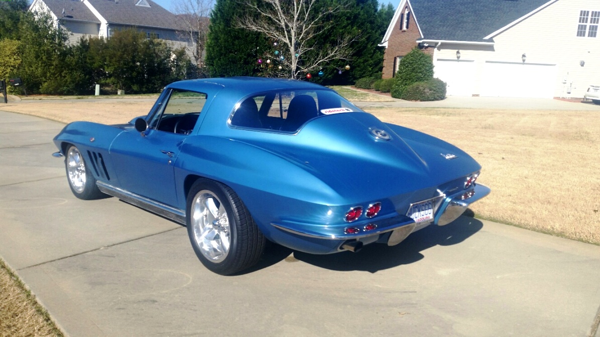

Nice alloy wheels in the photo shot outside the garage - what make are they and what size tires please ?

The rims are 17"x8" BMW rims off a 2010 5 series that I had kept after adding 19" custom rims to that car. The tires are Continentials 225/50/17" that were BMW factory installed on car when new. I used these rims while setting up all the new suspension by installed hubcentric spacers and they fit perfectly on hubs. I had offset trailing arms which handles the wider 8" rims on rear and I adjusted the front steering stops to eliminate the 8" front rims from hitting frame.
I added the polished 5 spokes rims a couple of months ago as this is my favorite style of rims!
I like the looks of these BMW rims as nobody else was using these "Euro" styled rims on a C-2. FYI....I used BMW rims on my custom 55 Chevy and my 69 Camaro over the years and have always gotten nice complements on the looks.
I would consider selling the BMW rims/tires if interested as I'm running out of storage space

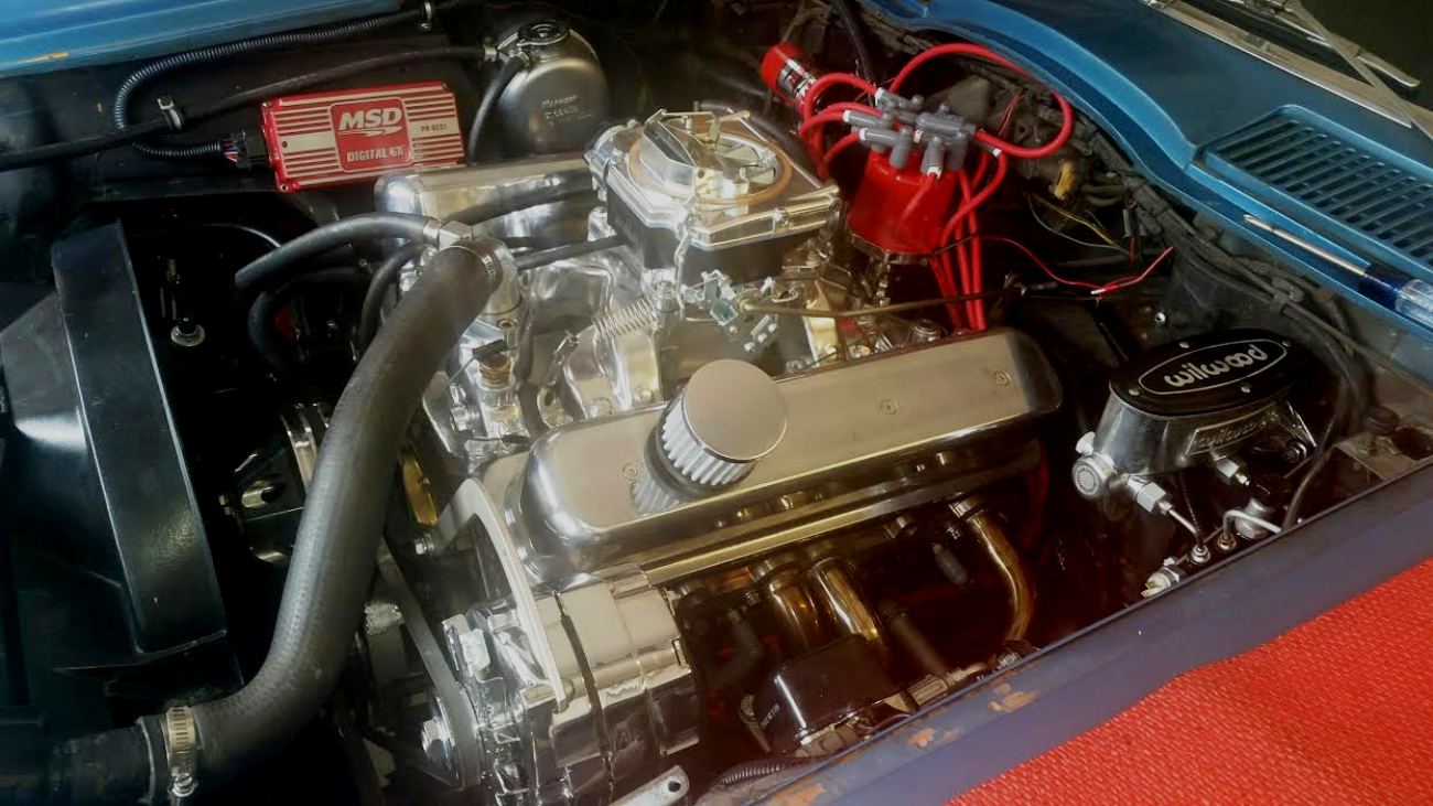

That picture was of the original 327 CI. here's some updated pictures with the new 383 stroker and Tremec 600 5sp. Also added some daytime running lights as a safety enhancement.

Nice! Can you show a close up of those LED running lights?
