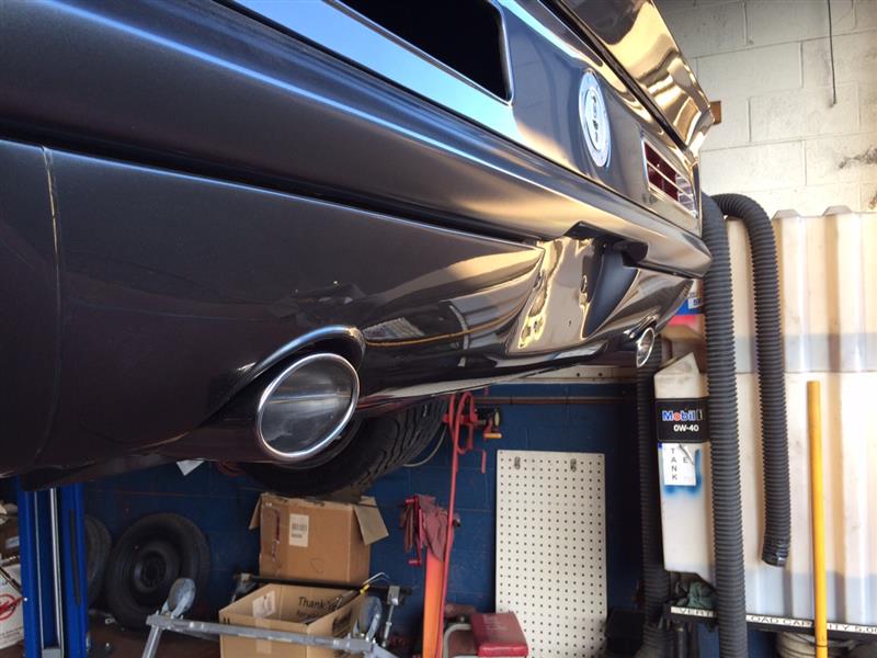

I didn't cut the big corner out of the truck like most do. I just cut out what was needed.
Also I kept it simple when I exited out the back. no fancy tips or machined tail pipes. Just a little bead so it didn't look like I just cut it out.

What colour is that? Looks great

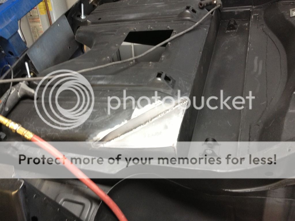

Here's an underside shot of mine. Car is on a rotisserie, tuned upside down. I'm running DSE Quadralink with 3" exhaust. Narrowed and corners notched on VaporWorx tank. Hope this helps.

How did you make that bead line?

Yes some pic's of how you did that bead would be very helpful. nice job
