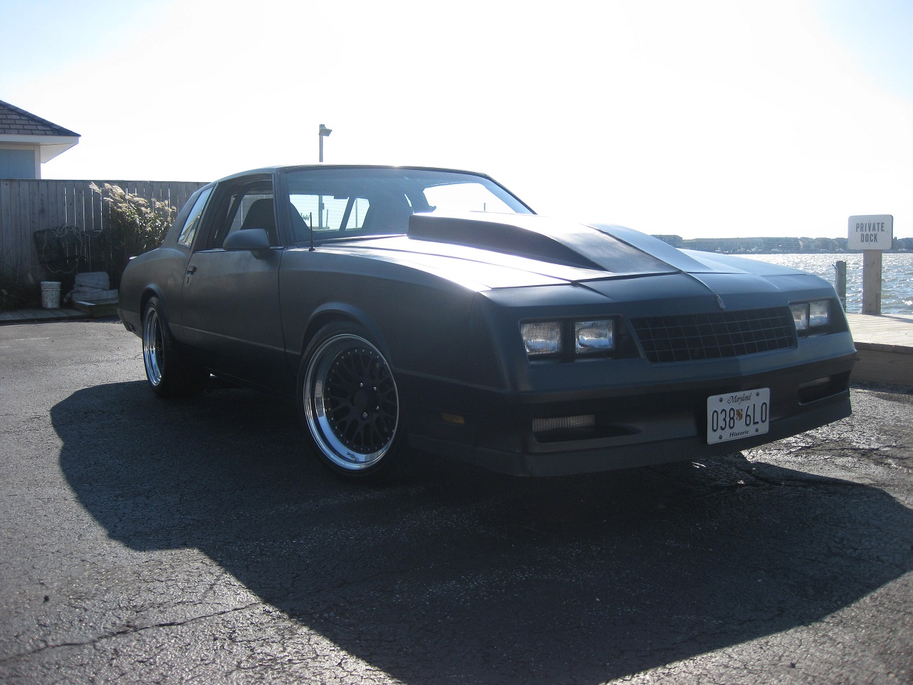

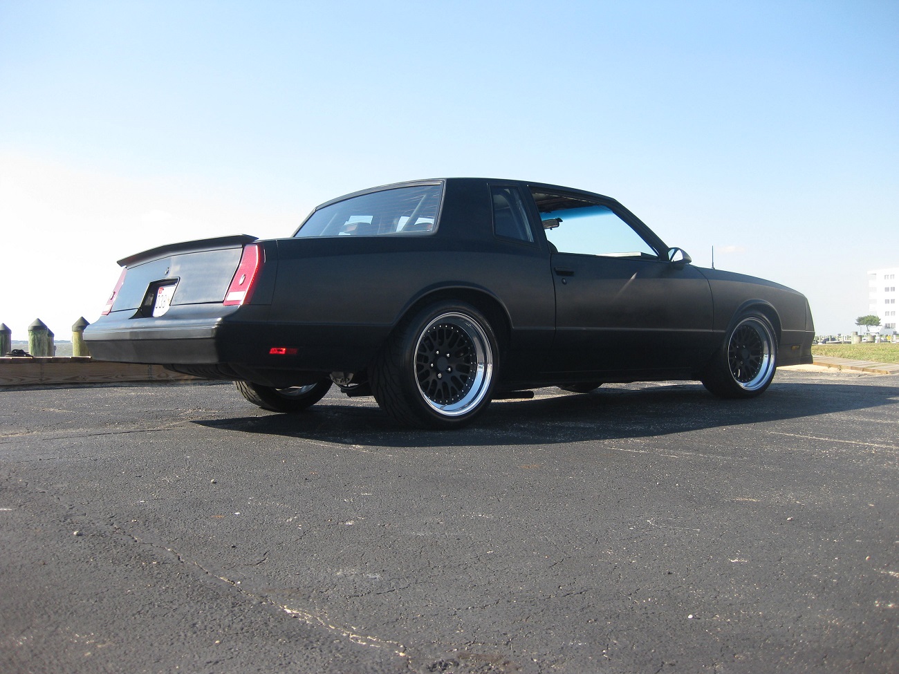

18x9" fronts 255/35/18
18x10.5" rears 295/35/18
18" classics start at $745 each full polish

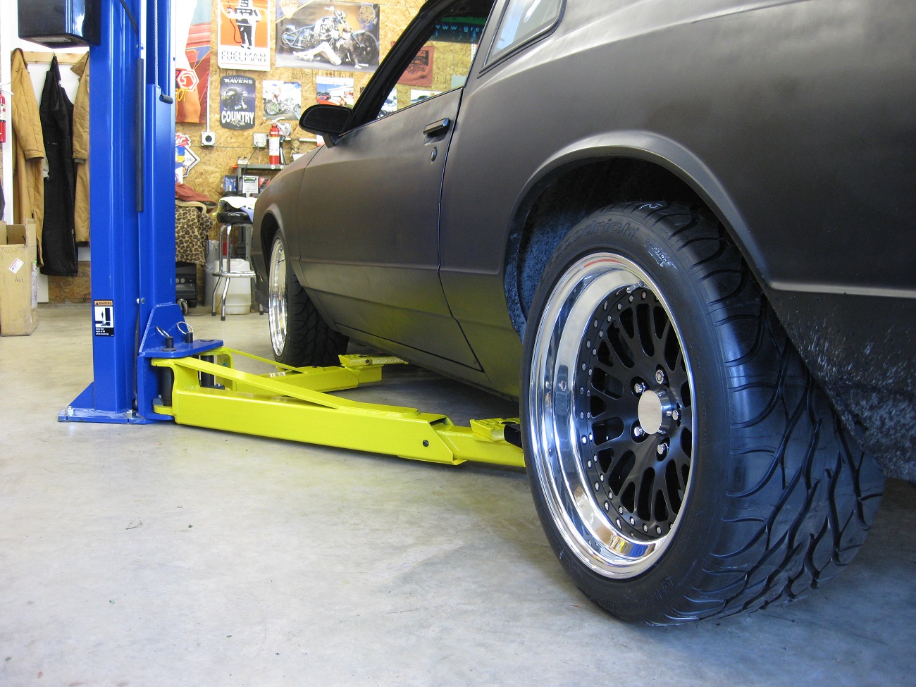

I am really happy to see this combo work on a gbody! Do you have any additional details on the backspacing, whether there was a frame notch, etc...?
Always loved the ccw wheels especially the sp500s on a new gen GTO.
How much would the set as configured run me?

That is Douglas Lutes car, do some searches for Sicmonte and you'll find him. Pretty sure they are 18x9, 18x9.5s but don't know the backspaces.
His car is 18x9" fronts 4.75" bs
18x10.5" 6" bs
18x10.5" 6" bs
Gotta be a notched rear frame with that backspacing.

Yeah, it has been notched.
