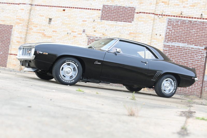

I am attaching a good picture of the car as it sits now for reference. Thank you all for your time and help! Looking forward to seeing what you think!
