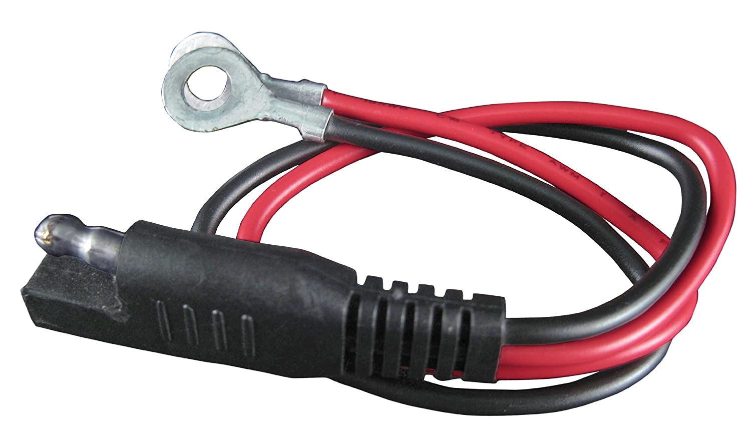

Why not just add the wire pigtail that comes with most trickle chargers ?

Ring brothers , Eddie Motorsports, feeler lots of companies make and sell nice charging ports . I'd agree with the trickle charger set up thou. My buddy has them on his cars and toys ....easy to tuck the lead out of the way.

Didnt know they came with those. I will be ordering an Optima charger today Thanks
