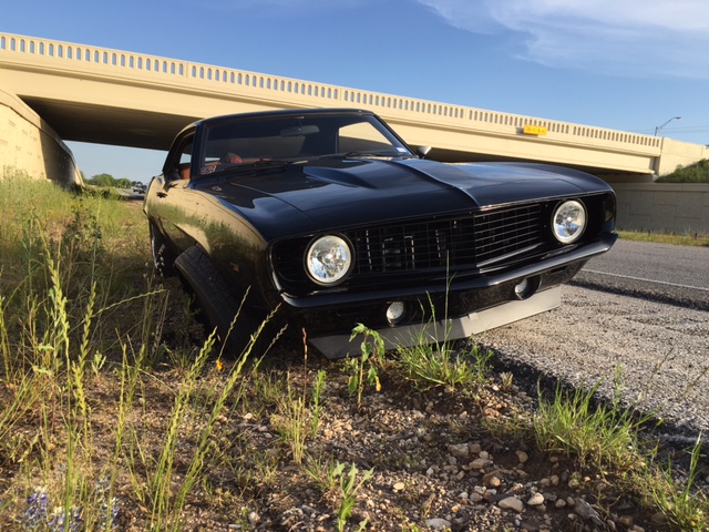

I have had my Nitto Invos on my car for 7 years and I'm finally starting to drive the car. I have only put about 500 miles on them and I had a blowout yesterday. I think the tire was low causing the blowout.
The tires look good, no dry rot, seem soft and sticky...
My question.... Are these low mile tires too old? I will compare with the new tire when I get it mounted. Thoughts???

The age of the tire had nothing to do with this, in my opinion. 7 year old tires are not that old, as far as driving goes. They most certainly have lost their competitive edge due to age, but should not have done this.
Are you sure your pressures were correct? It looks as though you had a sidewall blow out due to rubbing. I had a car do this once because I was running way too low a pressure, and my sidewall actually was rubbing on the pavement a little.

This particular tire always looked low compared to the others. The last time I checked it, because it looked low, was about a month ago and it was at 30.
The day of the blowout, I was washing the car and I planned on checking the pressure but I forgot. The car seemed to be fine for 20 miles then all of a sudden it felt like a flat, 15 seconds later it was obvious form the noise, smoke and vibration..
Another thought is that these wheels have two valve stems(one in middle and one on the edge 180 degrees apart. I'm thinking it was low and the stem in the middle, valve in the tire, popped off from hitting causing deflation...
