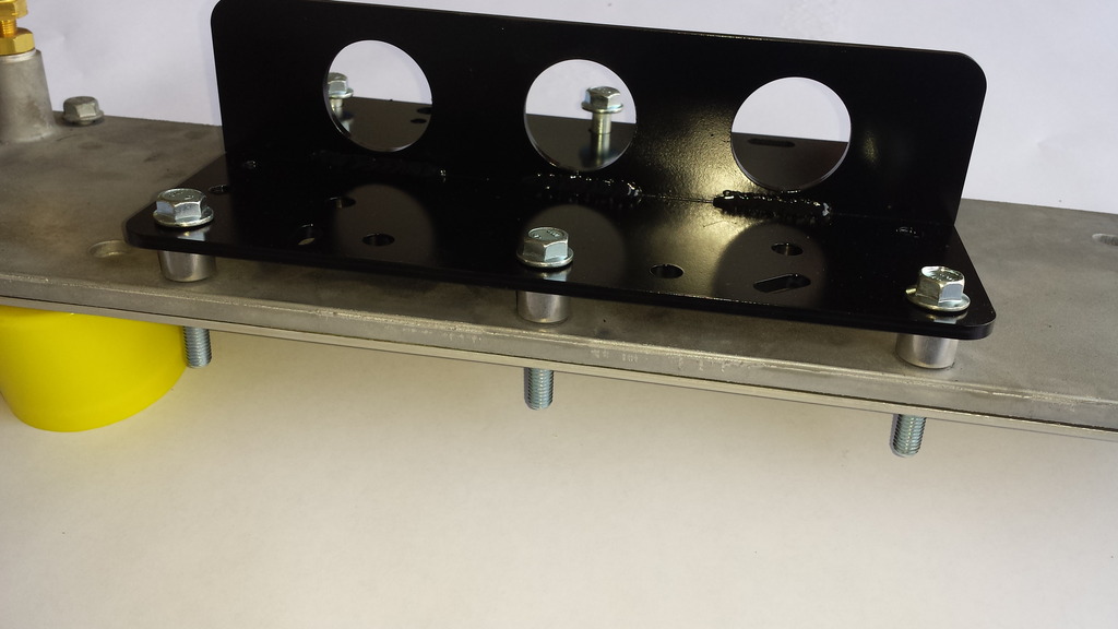

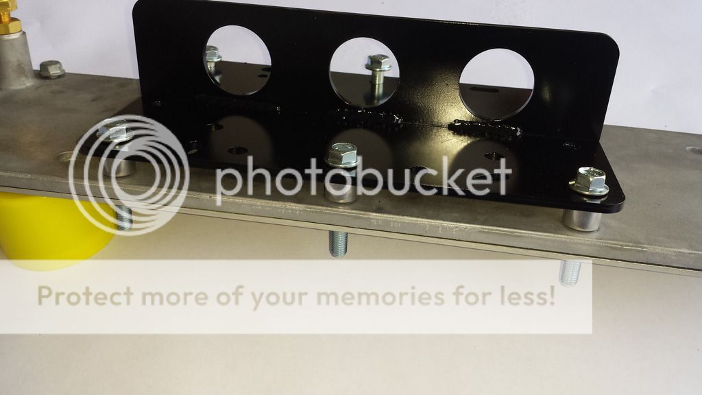

I have one I build that allows the valley cover to stay on and also works with a 4150 and 4500 manifold

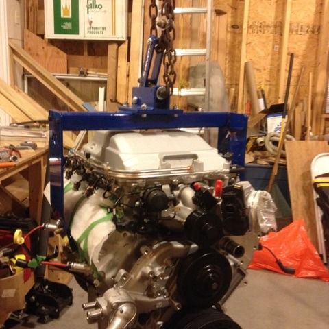

I use the adjustable one from Mac's...the adjustable feature alone is worth the cost in my opinion.
Old 04-26-2016, 10:04 AM
Thats the same one I have, it's made for the LS it mounts to the exhaust bolts so no need to remove the intake. Expensive but the tilt adjusts really easy.
I'be used it in that manner and also by removing the tilt mechanism from the tube frame and attaching it directly to the valley cover on top of the engine.
