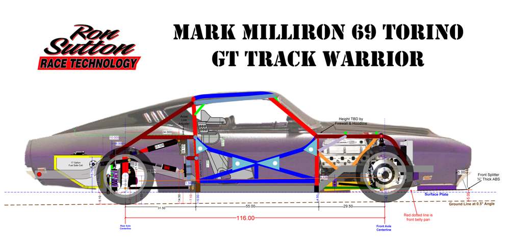

I have an order for a '69 Torino Track-Warrior we're starting the build for Mark Milliron in a few weeks. It will use the GT Front Suspension with long control arms & the engine set back. The Rear is my GT Rear Suspension with Shock Controlled Decoupled 3-Link. I personally don't build cars anymore. I have 2 shops near me ... with 25 year race vetrans ... I've worked with for a long time ... that build the Track Warriors for me. Randy Chastain, who was my GM of my 9 race teams & oversaw the building of all my race cars for 8 years and Mike Tolle, who is well known for building GT, DP, TA & many other types of road cars cars. These guys are VERY talented. Better than me. So I design it & provide all the parts. They build it. The blueprint below is Mark Millirons's 69 Torino with GT front & rear suspension. It will be a roller by August. We will be posting photos online of that build.
