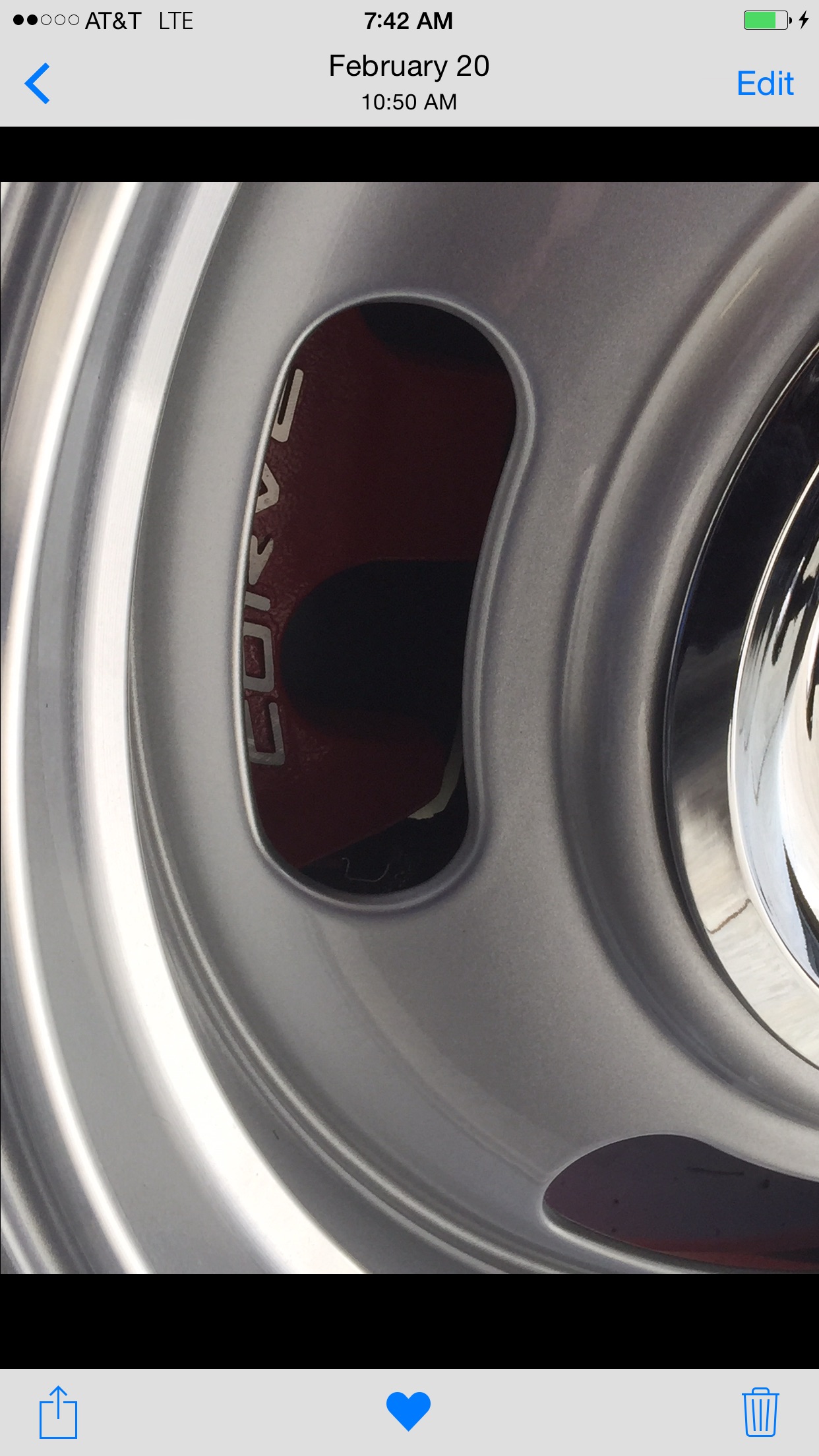

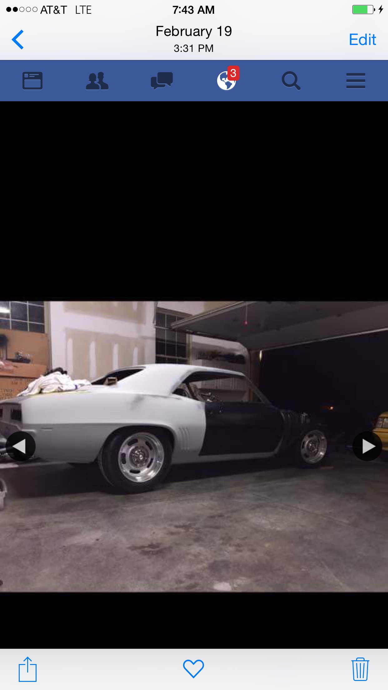

yes ive got 17x7 fronts with 1/8 spacer and 17x9 rears with no spacer

Here's some pics

More pics

What wheels are those?? ^^

Rev 107 off ebay 17x9 rear 5" bs and 17x7 fronts not sure of backspace has 1/8 spacer
