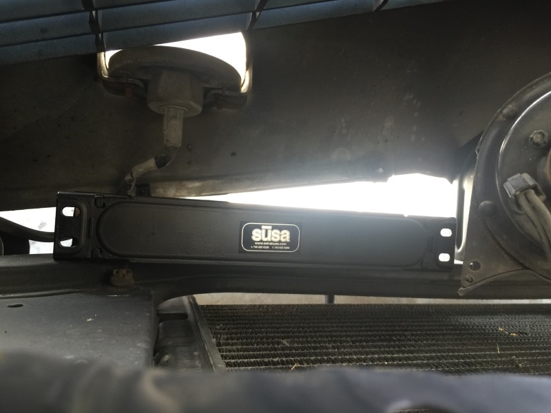

I ended up mounting it to the lower part of the radiator support. There's holes there stock already about 8"s apart . I ended up having to drill the back out of the outside hole since it didn't go all the way thru.
The cooler is mounted upside down. I figured it'd be better to get in the air stream then to mount it the other way but closed off. When the engine is on I can feel the fan pulling air thru.
