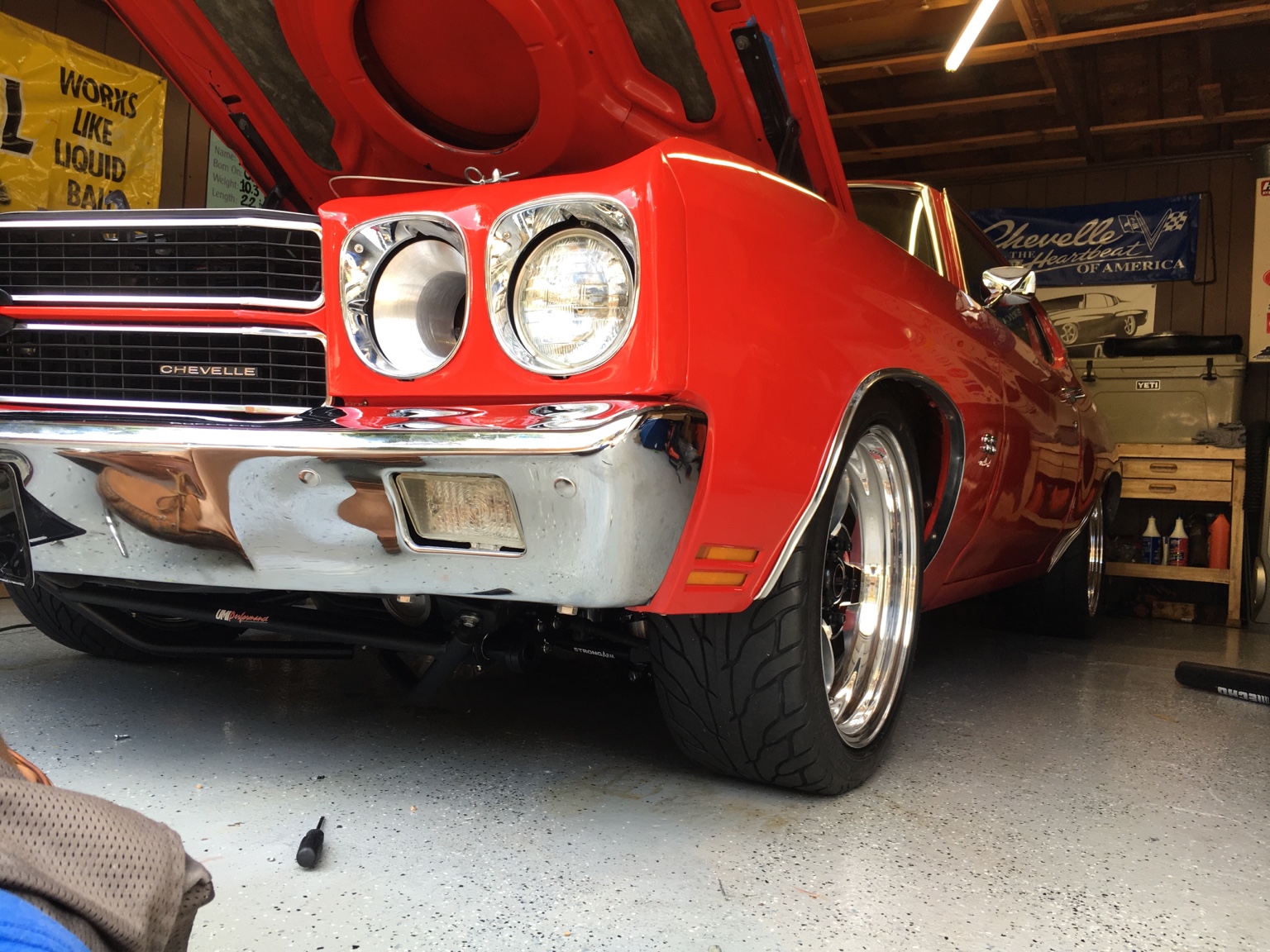

this car has the Speedtech A body Track time package plus the Chicane coilo over conversion and ATS Spindles. It has been doing VERY well at GoodGuys and Optima. it has 315 all around no mini tub modified inner front frender wells and outer lips but
