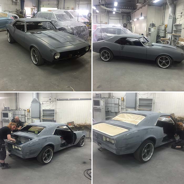

Pictures of my car...
Tattoo artist from Sweden with interest in old cars.
Instagram @tattoosoder

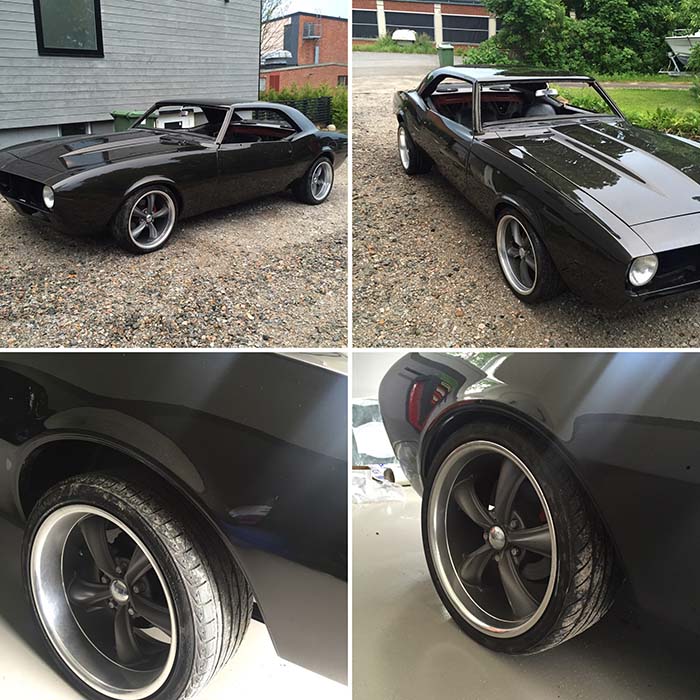

and this is pretty much how i want it to look. The look of the car will be some kind of "classic" look, and not crazy pro touring. My goal or working line have been "how a 67 camaro could look like from factory" if that make any sense
And that with modern parts...

and right now its way to small tires on the car. Want more profile to gain a little more "muscle car feeling". The rear wheels is 24" tall now so that is also a issue of course.
The plan is to go with 275 in the rear and PROBABLY 18" but it would work with 17" also...
So bring me your knowledge!! =)
