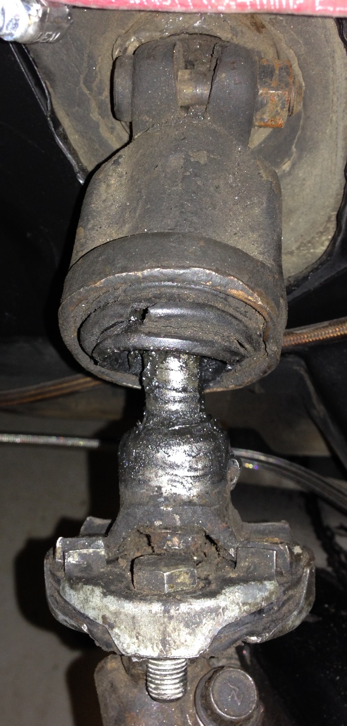

ok i have a 69 camaro that i am putting a 670 steering box in. it has a cupling on the end that has the rag joint riveted to it. i want to replace the part with one that will fit the rag joint for the new box. does any one know where i can get the correct part ? this looks like the stock setup from what i can tell. it is a tilt column. the closes thing i have found was

well i cant find any info on where to get this from so it looks like i need to get another column. anyone have suggestions on where to get a correct one from? looks like gmtilt is backed up on orders.

Can you post a different picture of what you have? The part you linked to should work on your column, but on mine (2nd gen camaro) that was attached to the shaft going to the box. We just put an IROC box in a 1st gen firebird and all that was needed what's the conversion rag joint and metric hoses.
