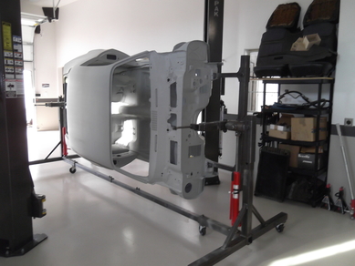

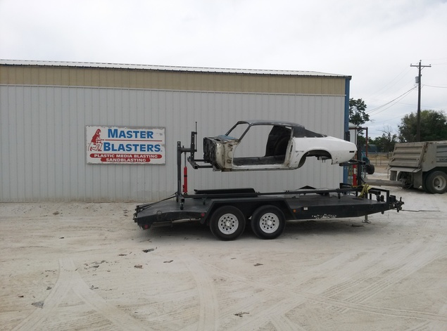

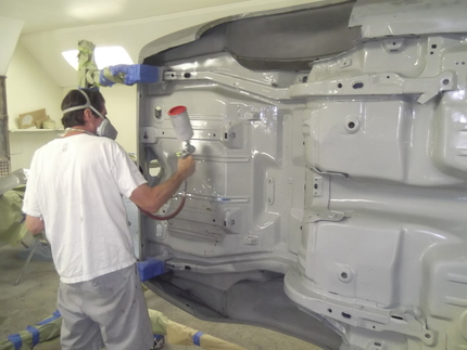

Started my project in March of 2014 and have been as focused as life will allow. Complete teardown, blasted, epoxied. Pretty standard plan ahead: DSE front and back, Forgeline-335/315, Baer, Cage all with my own touches. Much inspiration from the members here and PT, I've been doing most of my posting there, seems like more second gen builds going over here. Very much appreciate the expertise from everyone.

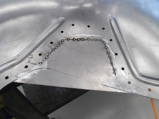

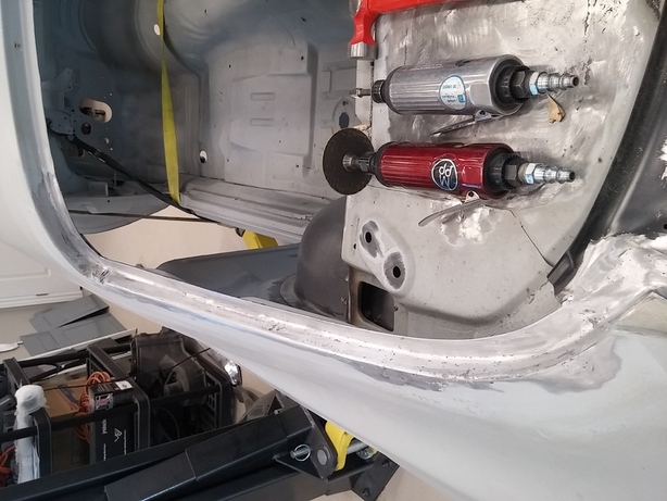

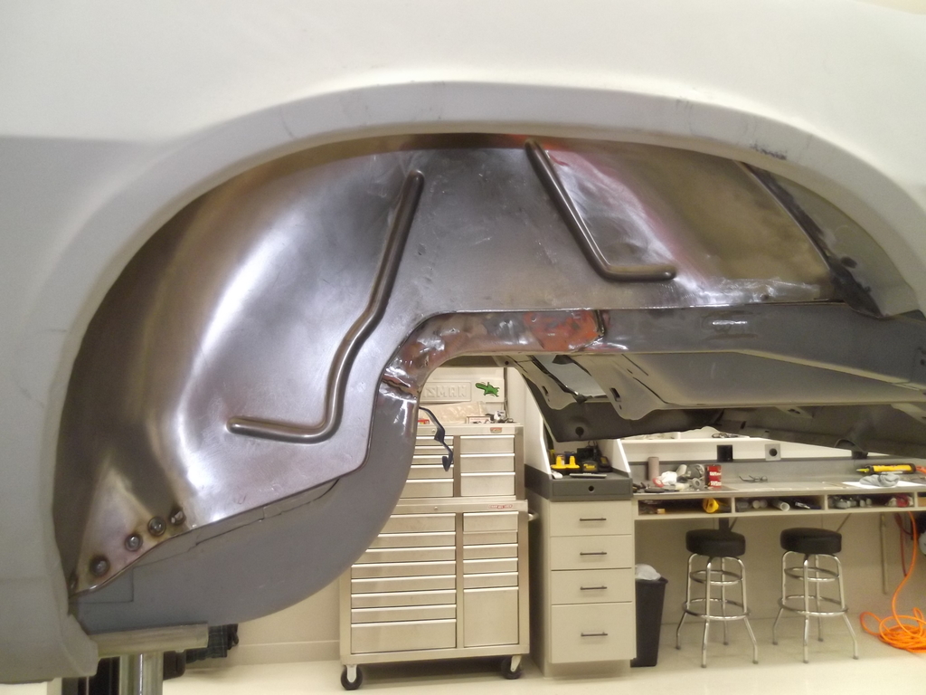

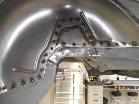

Tubs were next.

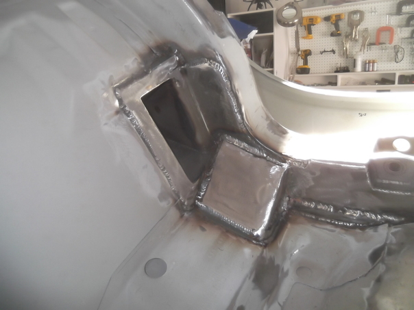

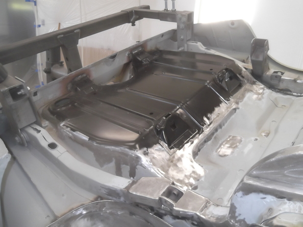

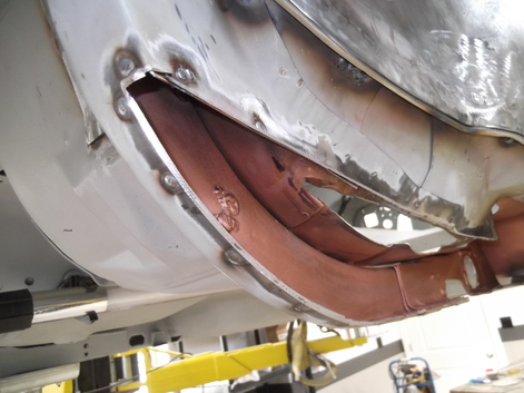

Then the 4 Link.

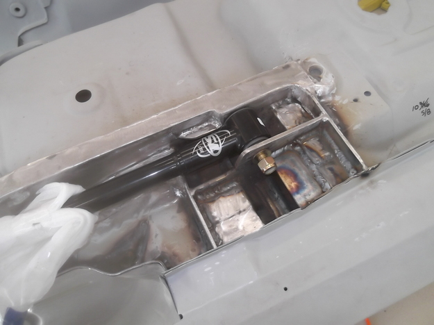

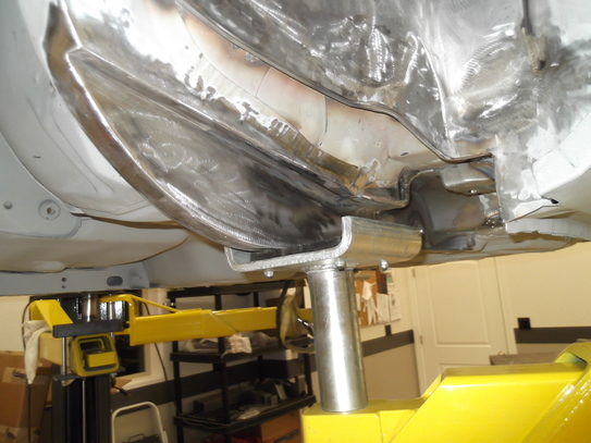

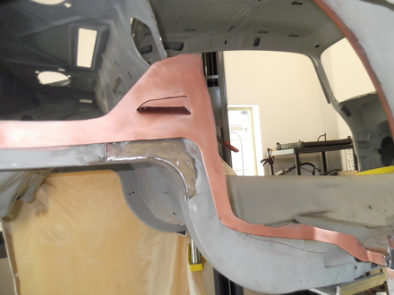

Made a couple changes to the lower bar mounts, trying to eliminate using the leaf spring pockets. Probably overkill here but I think it's a bit cleaner. Also changed the standard DSE lateral support to something a little stouter.

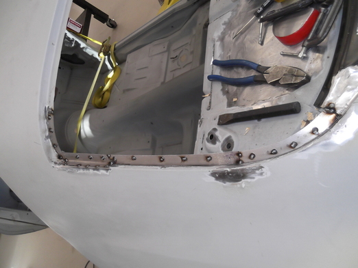

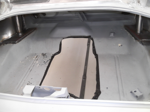

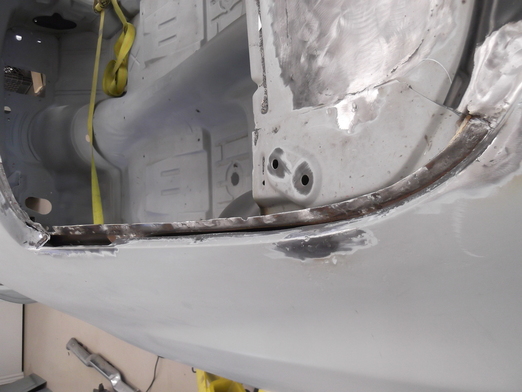

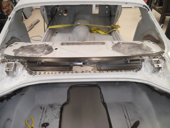

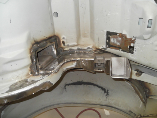

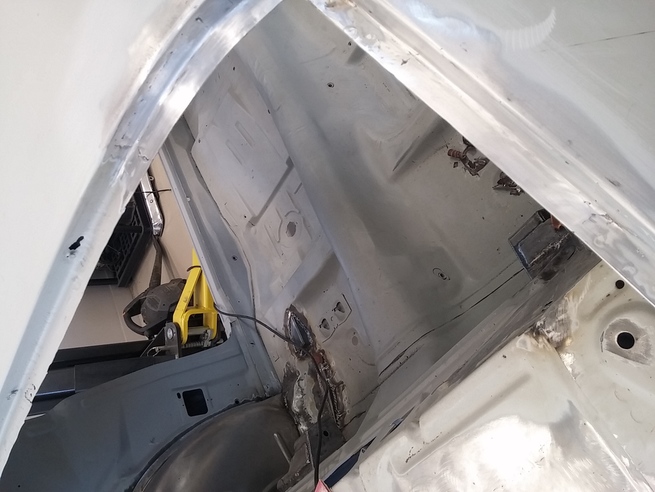

Very little rust overall but the trunk and rear window had their fair share. Replaced the trunk first.

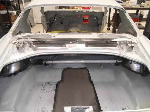

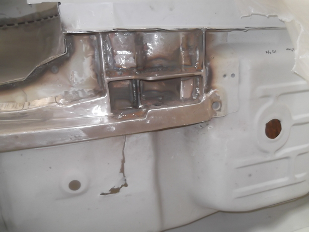

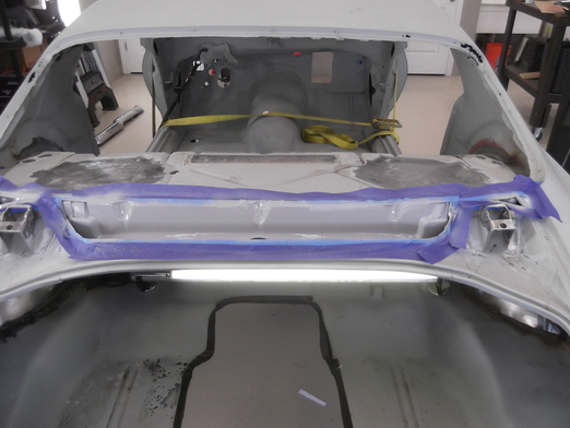

Replaced the rear package - trunk transition.

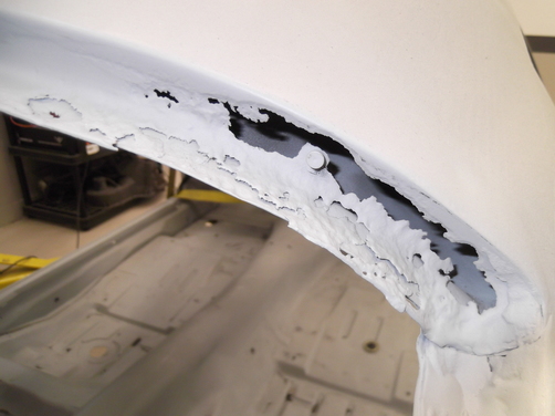

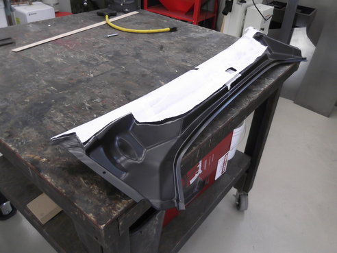

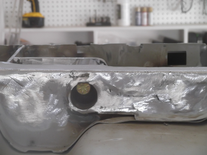

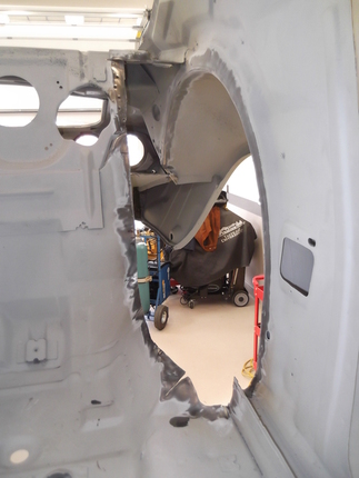

Cleaned up the rusted rear window sections. Plan on using the Fesler flush glass in the front and back.

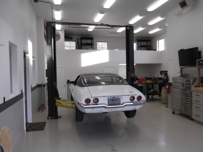

Nice clean work, love the shop.
