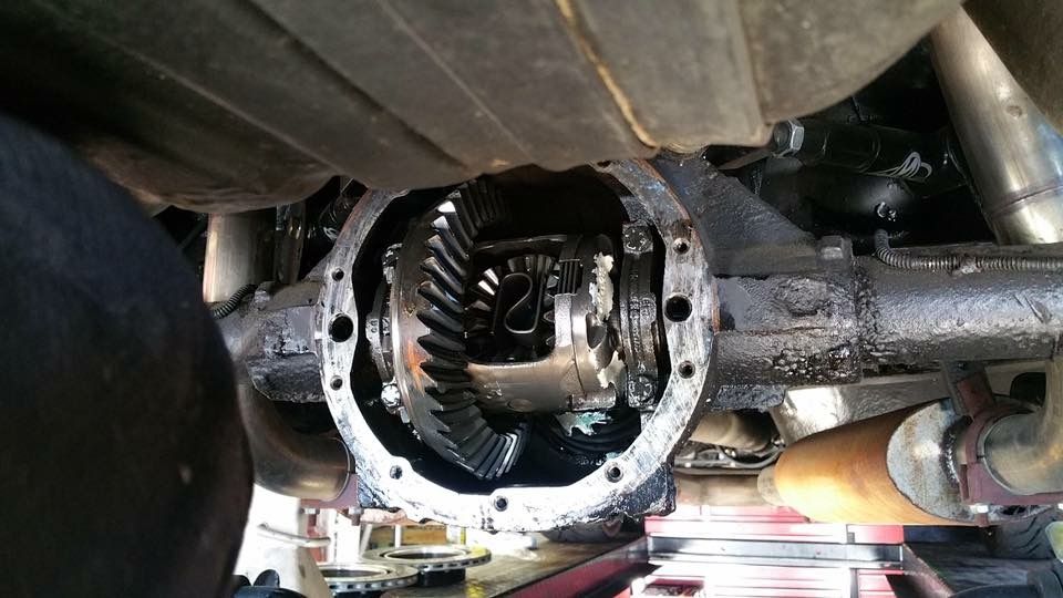

2. Eaton Tru Track & Timken bearings, races, gasket

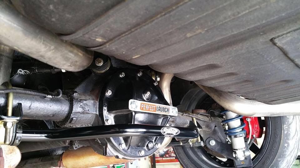

3. Perfect Launch girdle rear end cover

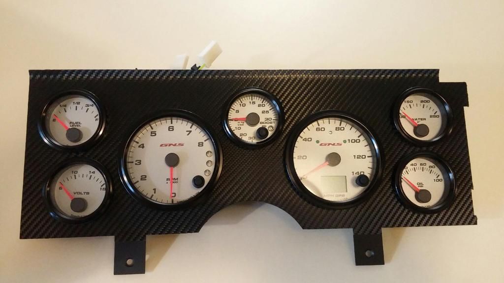

15. All new speedhut racing gauges.

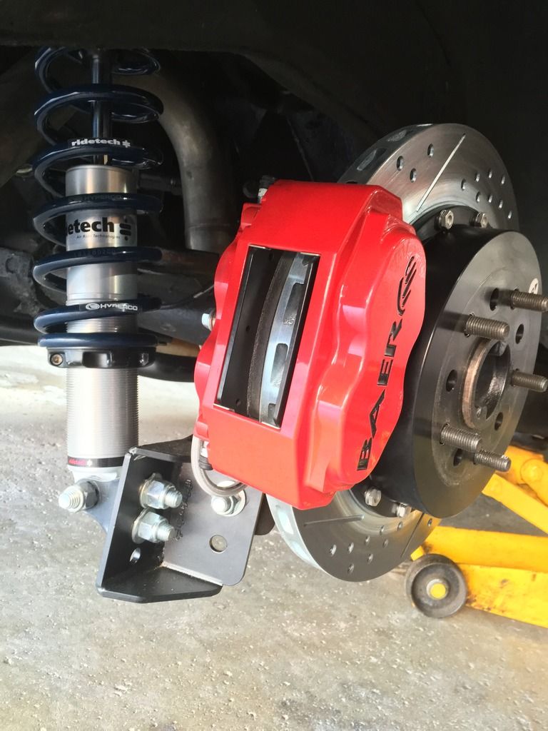

Baer big brake conversion kits front and rear.... no more rear drums!

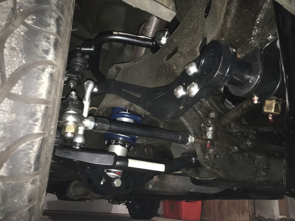

Front suspension shot

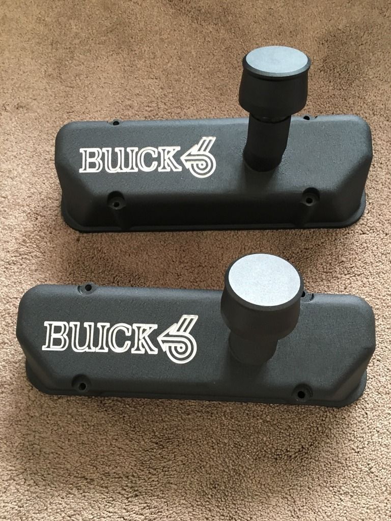

3" dual fan radiator............racing baffled oil pan..........valve covers that oil dont pour out through!!!

I think the brakes are awesome... there is a story behind that tho!!!
I first installed the front Baer brakes about 5 years ago. At the time, i gave no thought to the rear brakes and did no adjustments there...
Well that bit me in the rear because i glazed my front pads because the front brakes were taking all the braking.
5 years down the road i bought the rear drum to disk conversion kit. I had some issues during the install and after... I believe i got those issues addressed and now my only concern is if the proportioning valve is set correctly.
Actually looking for a great brake shop here locally (Detroit area) i have a line loc kit i need installed and i wanna have the brake line pressure taken at all 4 corners to make sure everything is working properly...

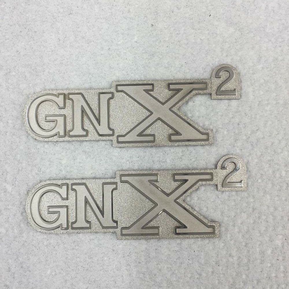

Custom GNX squared badges being made for car.

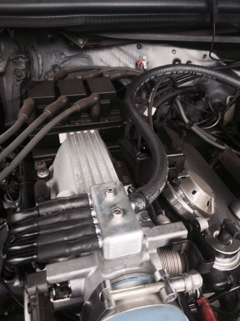

Engine Bay and transmission now:
