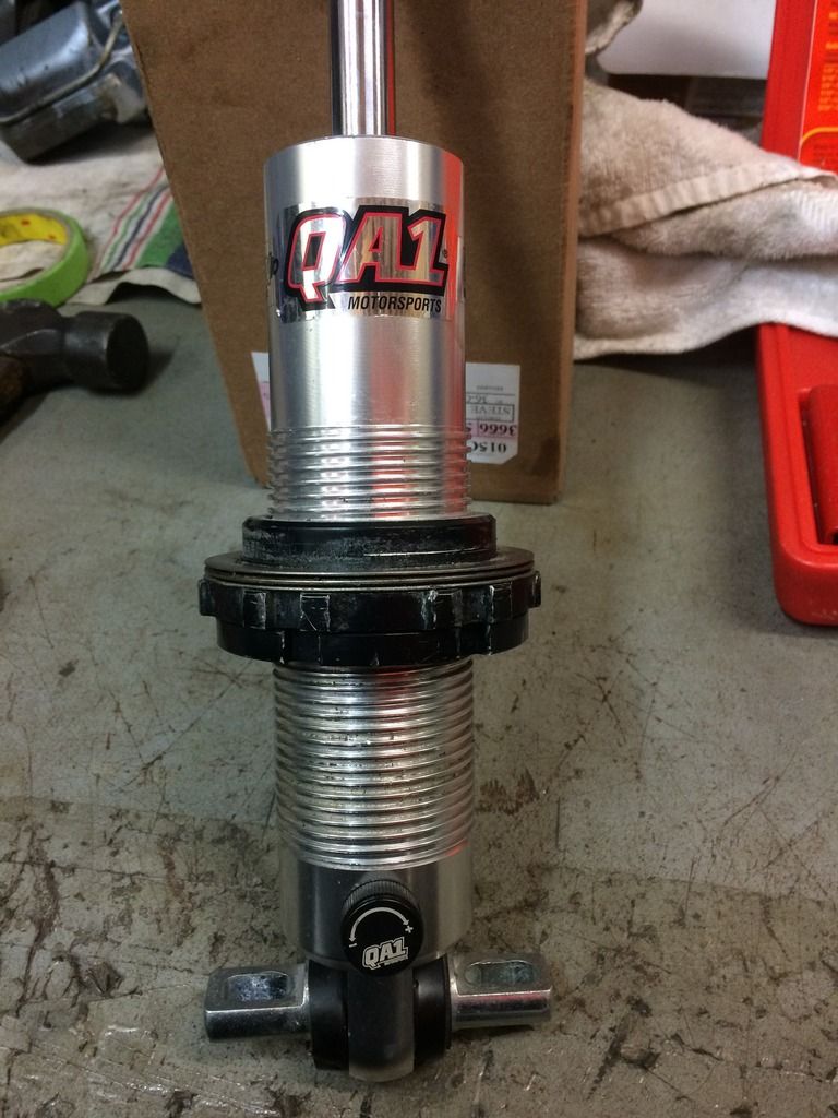

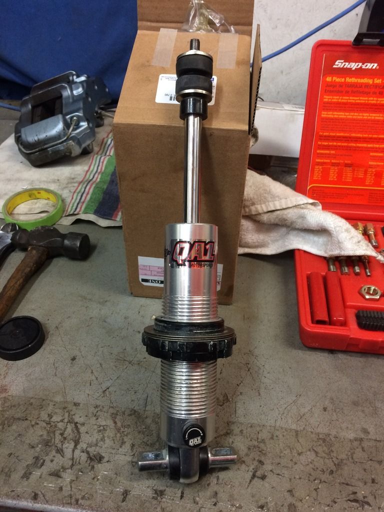

Posting a couple pics showing what the adjustment is at for the ride height I want. The ride height was perfect with the front tire just tucking into the fender
well. Do you guys think the adjustment is cranked up too much to achieve the ride height I'm after? At this adjustment the coils had around 1/2" between each other.

I tend to agree with Rod, I would expect to be running a much heavier spring say in the 500 to 600 range. That said, you should be able to adjust the ride quality with the shock adjustment.

i would have sold you 550 lb springs for that combo.
just to ad gas to the fire. i think 350 is too light and agree with Rod that you then need to adjust the compression way up to have the car not bottom out.
