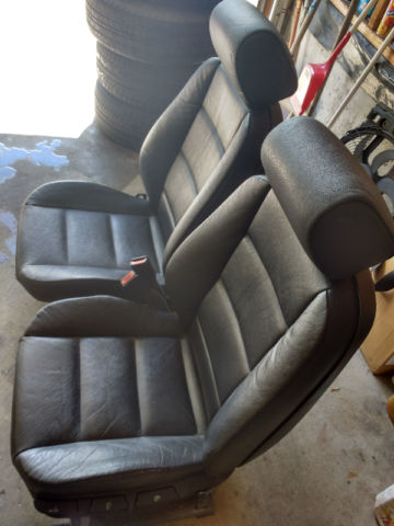

I have an opportunity to buy a nice set of BMW manual leather seats that measure out 37" high x 22" wide x 19" deep for a good price and was wondering if any one has attempted the conversion and or welded some new mounting brackets and could give some insight.
I'm planning to shelve my originals that were re-foamed, still uncomfortable & try something newer that cradles the body better.
Any input appreciated.

What you need to be careful is the seat base height of those being power seats.
Width is ok, but what you really want to find is a pair of seats like below, VERY easy install

Steve, the ones I'm considering are not power seats and have a height of 8-9" which is close in relation to the factory setup. The problem arises I guess if the seat height is high then you risk your head hitting the headliner.
Measure in 4 places and purchase once in this case.

Yup, 8-9" are far too high, you'll be hitting your head (depending on how tall you are)
Can you weld up your own seat brackets ?

Picked up the seats, made by Lear...even have a manual height adjustments. Will post something up if they work out.
PM sent.
