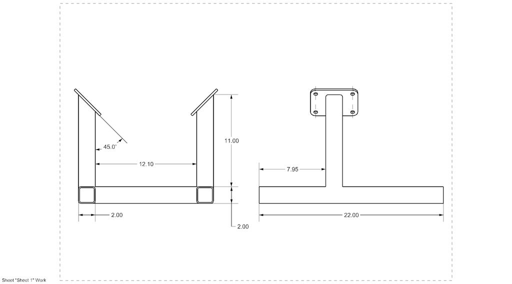

2" SQ Tubing

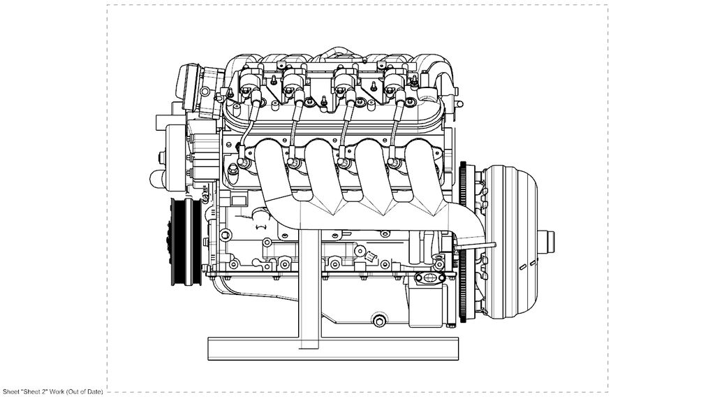

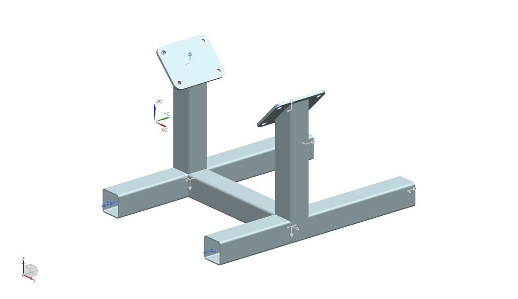

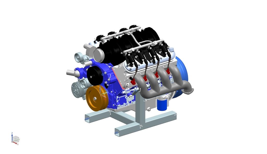

This was something I drew up real quick. I had the LS3 engine model, but internals are not there, so not sure where the center of gravity actually is. Figured legs the horizontal pieces near as long as the engine would be good. If you were storing it with the transmission, you would need to make them longer, & I would put a trans mount on it to for support on both ends.
Scot
86 Monte SS
LS2/T56 Magnum
