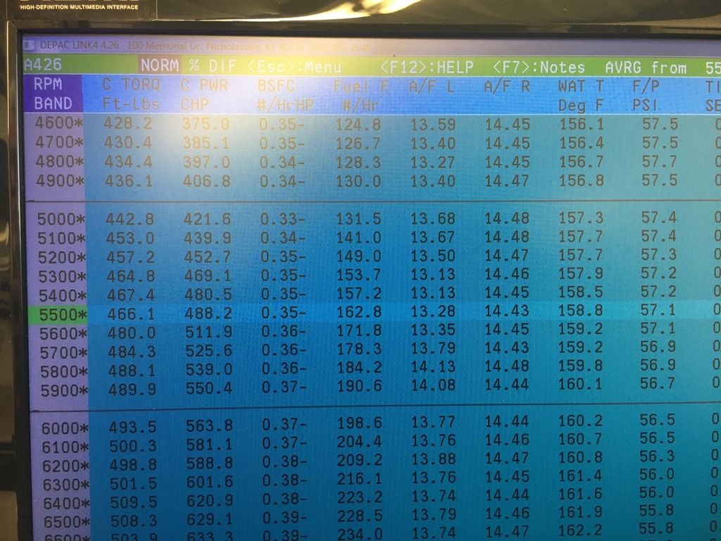

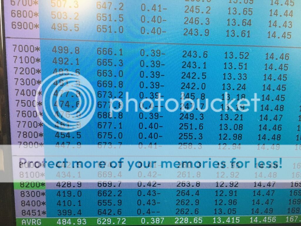

For those that prefer graphs, red is hp and blue is torque.
