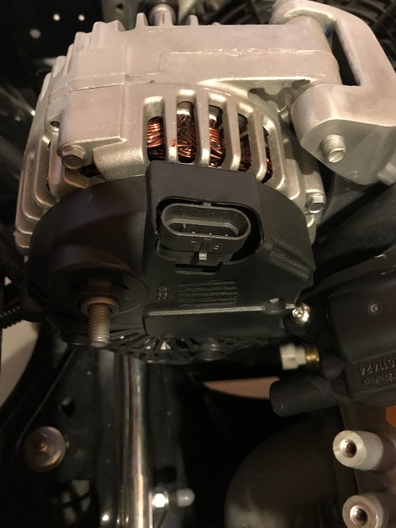

First excuse me if I muck up posting these pictures, I'm trying out Image Shack
I have a question I got this alternator with my LSA connect and cruise kit, it has 3 posts in the connector but the harness came with a 2 pin connector. I read that the new alternators are more like generators in the way they work and that is what is on the tag for the Alt. it says Gen. I'm trying to figure which alternator is supposed to be with my kit. I send an E mail to the dealer I bought it at, but figured I would check here.
Difference in alt to connector.

i just checked my LSA (connect and cruise) alternator and mine has 4 pins, i haven't opened the harness yet so i don't know if they match up.

LSA Connect and cruise instructions state that the use of the alternator control is optional and then they toss in this warning:
NOTE: If you are using the Chevrolet Performance or production LSA generator DO NOT plug in the generator control wire into the generator. This will result in the generator defaulting to only an 8 volt output above 3000 RPM.
I think you will be better off using the alternator you have and wiring in the appropriate plug. Holley sells one if you are unsure what plug to get.

Memory is fuzzy but I went through this last fall.
You got the right alternator for the kit but it won't work with that (GMPP) ECM as that alternator needs a PWM signal in order to regulate voltage.
GMPP solution of leave it unplugged and it will run at 13v was not acceptable to me.
We used a AC Delco 25766345 alternator for a 05-07 CTSV and wired that to the ecm and it charges at 14.6v It has the same connector as your current alternator but only 2 pins in the middle.
More info here. https://ls1tech.com/forums/conversio...or-wiring.html
