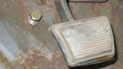

Name:  IMG_0545 - Copy.jpg

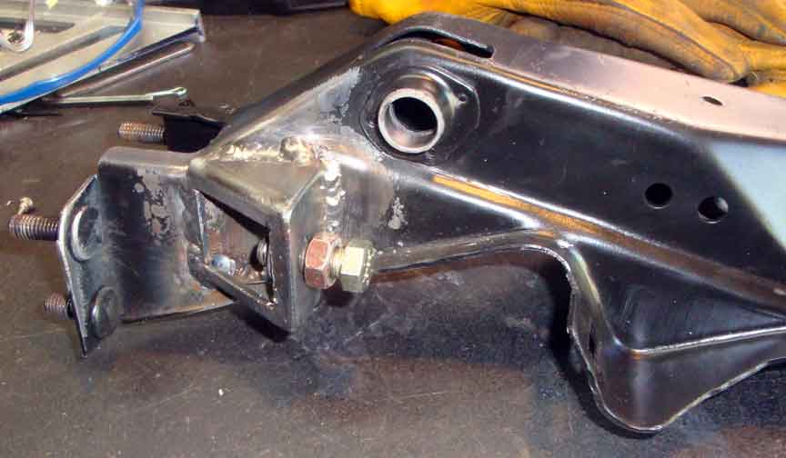

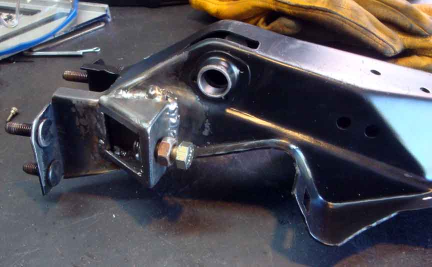

Here's mine, its adjustable and simply bolts to the firewall. Also incorporated a 02 f body safety switch.
Can you elaborate on how you incorporated an 02 safety switch ?
Thanks.

This pic should show how I attached the switch mount. I got the switch tab from the donor car but one could be made fairly easily.
It's a simple open/close switch. Plan is to just wire it inline with the starter solenoid. Testing with a meter it gets a closed signal very early while depressing the plunger. So hopefully I can fine tune the pedal stop without having to move the switch.
