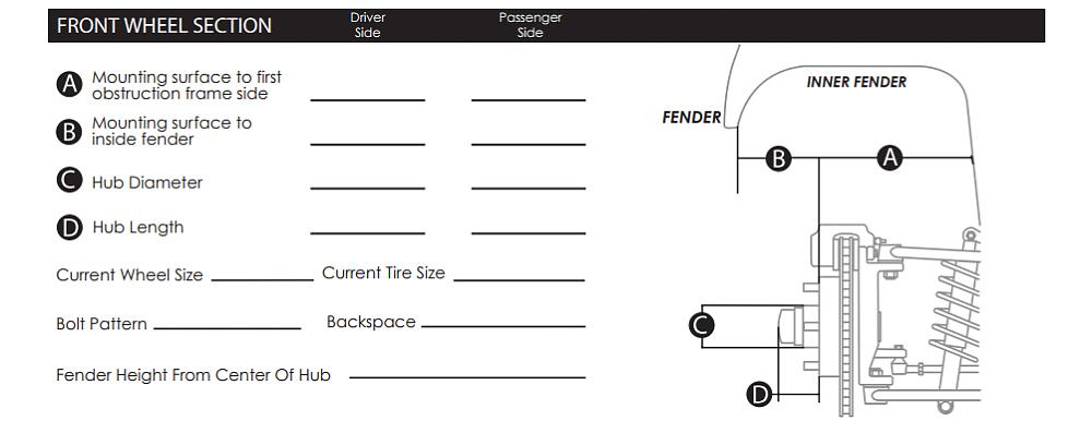

Here are some guides and the measurements we ask for when someone orders new wheels.
Front End

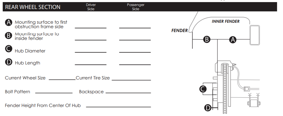

Rear End

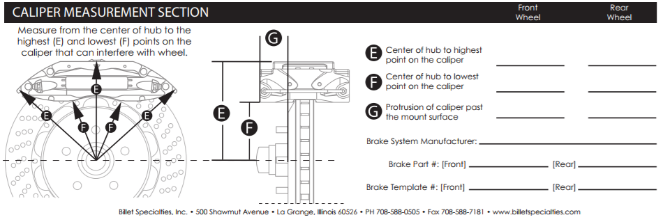

Brake Caliper
