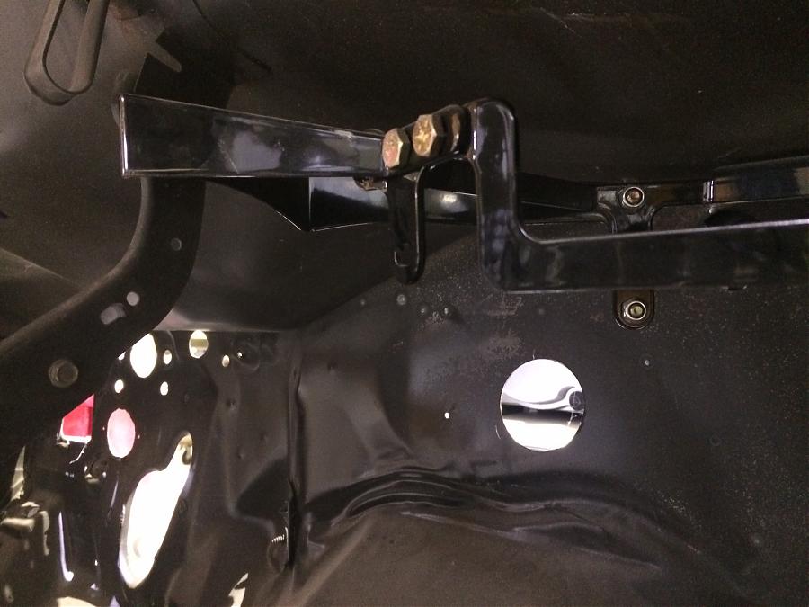

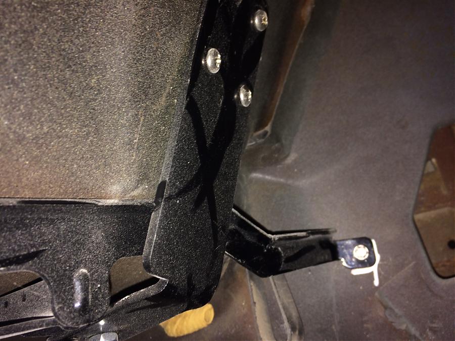

Here are a few pics. This is a factory air car if that makes a difference. Not the easiest thing to photograph.
Excuse the mud dobber nest. Just got back on this project after a 2.5 year break.
Don
