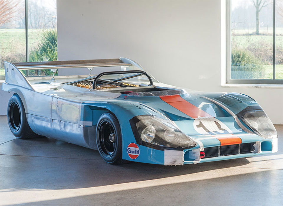

Here is the real deal.

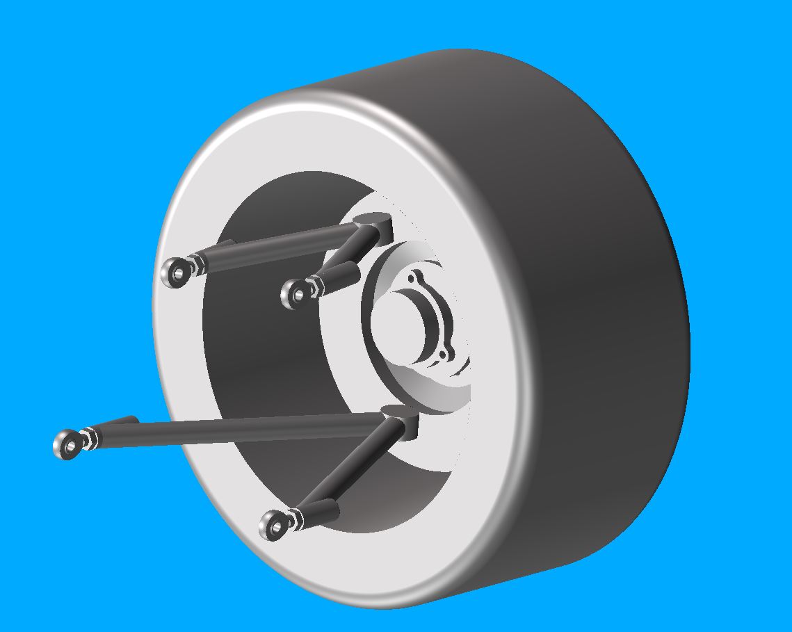

Here is the CAD version of the front left

The rear was more like this picture with longer trailing links going forward but I will go with a H shaped lower and an A-arm for the upper. That will work better with a deep backspacing. The Porsche die hards will hate me but I'm building a car for me not them.

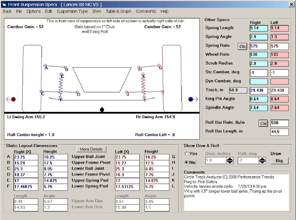

Ron Sutton posted shots like this from Performance Trends in my build thread.
He may be able to explain how it was done.
Lance

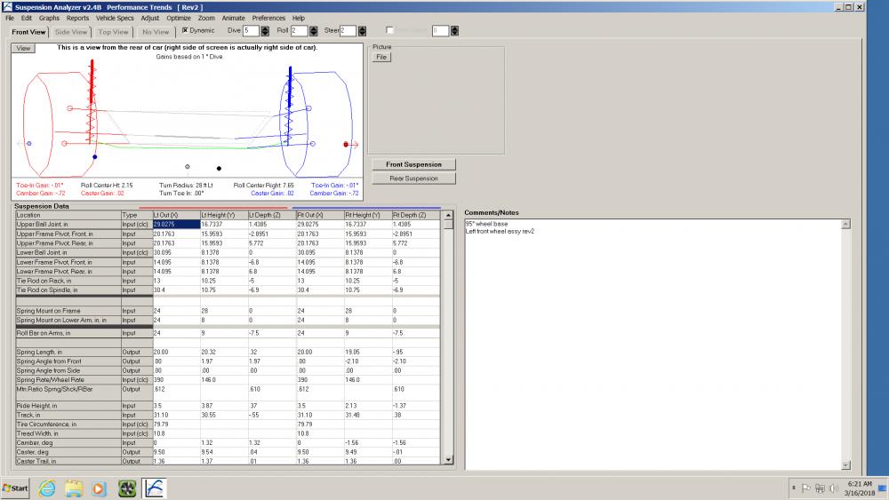

I've been working on the suspension in CAD and had to make changes so the upper arm does not come in contact with the wheel at full lock doing an 18 ft radius turn. I am thinking about no anti dive or squat. I figured out how to print screen into paint and post it. Still lots of spring rate, roll bar and other things to be worked on obviously but what do you think of these numbers with 1/2" dive, 2 degree roll and a tight turn? Am I getting closer?

I haven't looked at the file but none to a little anti dive in front will work. A low CG car like that with high rear weight won't have a lot of dive transfer anyway. The rear needs anti-dive anti-squat. With IRS you won't have much anti squat effect due to drive train housing torque like a stick axle car, but it needs as much anti-squat as you can get. I expected to see 60% rear weight, would like to hear your comments on what you think a good rear weight percentage is.
On your front lower A arm, I would not use rod ends on the inboard ends. I'd make them spherical bearings in a housing welded to the arm ends and jig weld them so they are identical. There is going to be a lot of front to rear loading on them from braking and side loads on rod ends will wear them out or break them in time. Do all your adjusting on the upper A arm.

I just got the Brian Redman book and he stated the 917 Prototype was aerodynamically unstable. The fix was to raise the tail to increase rear downforce. Perhaps the wing used in the photo and the small lip spoiler helped enough on the car in the photo but be aware of the issue.

As for the Aero issue, yes the 917 Lemans cars in 1969 had a little wobble at 240mph on the Mulsanne straight. They changed the tail shape in 1970. The Can-am cars never got to that speed and were shaped like the first picture of a 917/10. As for the weight balance it helps to have me(200lbs) so far forward, the pedals are actually on the center line of the front wheels along with the battery, radiator and two sidepod fuel cells in the front half of the chassis.

I’ll take a look at your file when I get time. I recommend consulting with Ron Sutton to get some help. I did see on the previous file, the roll center moves outboard with 2” dive & 2 degrees roll. It would be better to have ithe RC stay closer to chassis centerline or move towards the inboard tire. I don’t know how to accomplish it though. Your dynamic camber looks very good. I’d read Ron Sutton’s sticky thread in this forum for what he likes.
