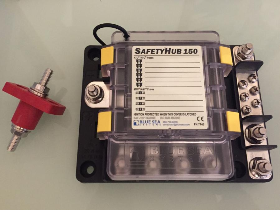

I'm looking at running this one.
for my setup I'm running a 1/0 gauge wire direct from the battery to the starter with the solenoid in the trunk. So it won't go near this terminal.
Then I'll be running a fused(or 80A circuit breaker) 8 gauge wire from the battery to one bolt on this terminal and either an 8 or 4 gauge from the other terminal bolt to the alternator. allowing a bunch of other fused power wires to be connected in-between.

I went to West Marine and bought something like this for my grounds and positives for fans at the front on the engine bay. I then ran 2 10g wires to feed it. Only issue is its not covered for the positives but haven't had any issues.
