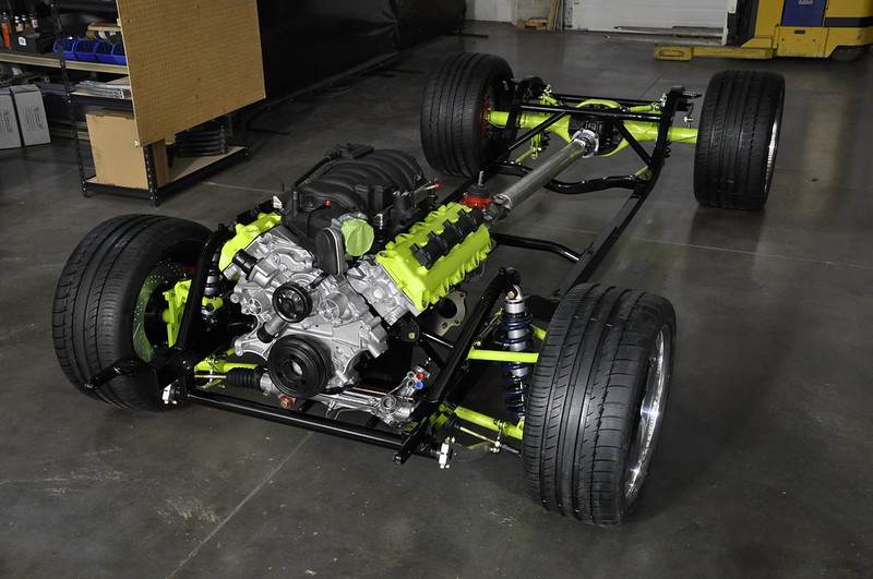

Old 05-11-2018, 04:58 PM
Schwartz Perf Schwartz Perf is offline
Supporting Vendor
Join Date: Apr 2012
Location: Chicagoland
Posts: 399
Thanked 42 Times in 18 Posts
Yes you're looking in the wrong places!
We have a full chassis available for 68-70 B body, 70-74 E-body.
They are the only one out there that "bolts in" to the car with minimal floorpan mods.. Unlike more universal chassis that require you to cut the whole floor out, build mounts, or weld it to the rockers.
Where have we been? Well the B-body chassis was introduced in 2009-2010 and the E-body in 2011.
Check it out here: http://www.schwartzperformance.com/m...is-full-frame/
and
Here's a few photos:
-Dale
SchwartzPerformance
Where classic style meets modern technology.
SchwartzPerformance.com
GMachineChassis.com
LSxEngines.com
Facebook | Instagram | YouTube
