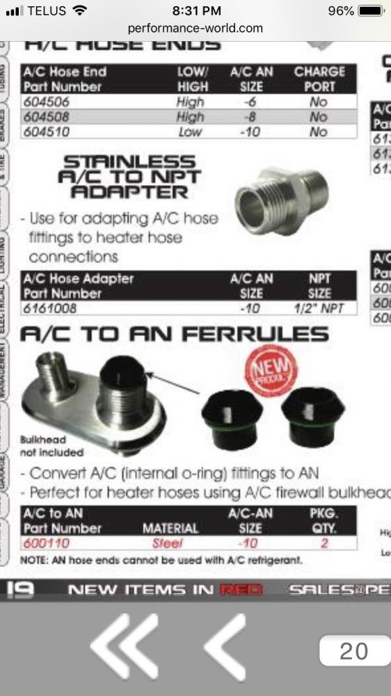

I used these conversion fittings on a vintage air bulkhead so that I could run AN fittings for my heater hoses. Might be an idea, they are from a company here in Canada called Mopac Auto Supply and they are sold under the Performance World brand.
