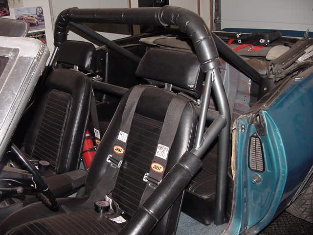

Old 08-28-2006, 07:57 AM
Rob07002 Rob07002 is offline
Join Date: Apr 2005
Location: New Jersey
Posts: 199
https://lateral-g.net/forums/showthread.php4?t=5139
Some pics of my bar. Definatly go custom.
