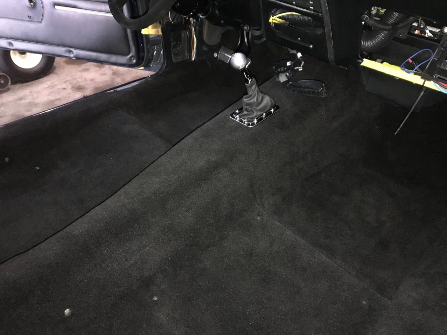

Shane, that carpet kit looks great, what brand/type did you get and did you need to trim it?
Hey Tony, thank you! It's actually not a kit. I initially took it to an upholstery shop on a recommendation, however, the guy did the biggest half-azz job I've ever laid eyes on. When I got it home where I could examine it closer, it only looked worse. He used some cheap carpet and laid it down in one piece which would've been fine had he done it correctly. I messed around with it to see if I could salvage it enough to get by. It turned out better than I'd hoped so I kept it for the sake of moving forward. Once the seats, etc were in you can't really see too much of the carpeting anyway. You can get some more details from my build thread.

Well from the pic it looks good...thanks for sharing!
